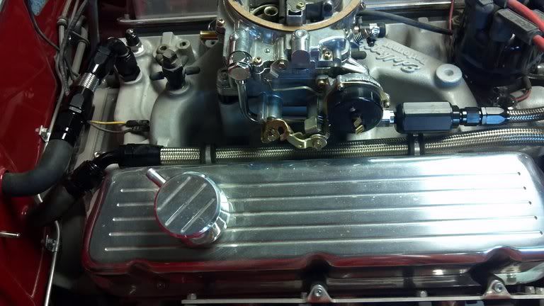

Hose and fittings from Jegs. I had a few sections of heater hose with 90 and 45 degree bends that I ran through the firewall.
