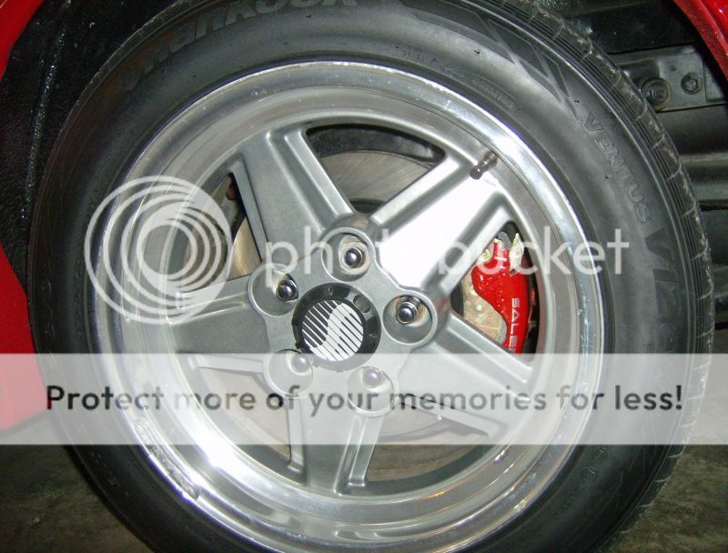

A couple shots of the front brakes: (New 73mm calipers, hardware, Hawk pads, cryo-treated Powerslot rotors, <$200 invested!)

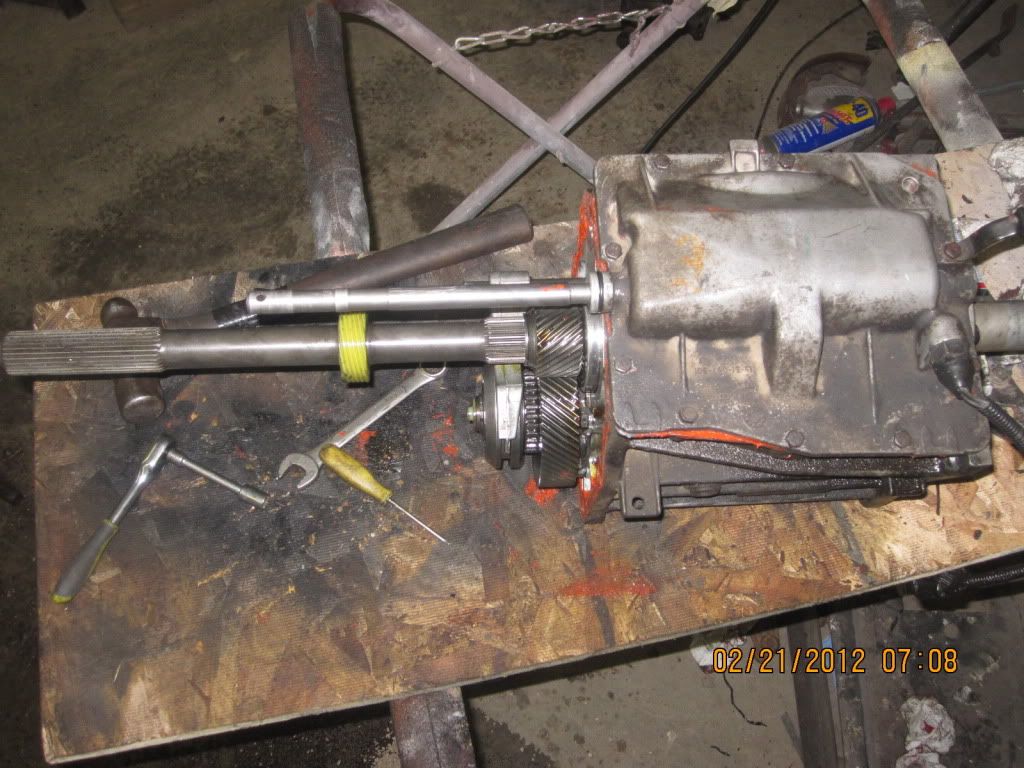

Must be a transmission week? I have been so busy i got a little time this weekend to LOOK at my car for an hour, But saturday some kid called on my craigslist add for my C4 We swapped trannys, I got the better deal I traded my C4 no bell/no tc/ and a B&M ratchet for this T5 World Class W/bell/new clutch/flywheel/clutch fork- I tore it down today and was amazed, It's like new :yah :yah :yah after a good cleaning it should be tip top Shifts smooth just like Marks.- I also put in my clutch pedal/bushings/and Modern Drive clutch pedal mounts Very pleased with how my luck is turning! :yah
In case you are not aware, most if not all T5 equipped cars had the 50 oz imbalanced flywheel... if your engine is an earlier 28oz imbalance, then you'll want to be sure you've got a correct 28oz flywheel.

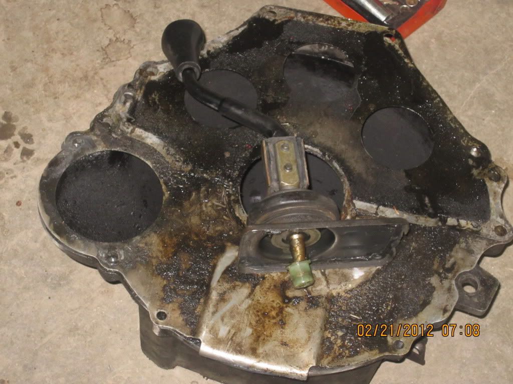

and the tranny and bell.

How much is that hydraulic TO bearing setup?
Must be a transmission week? I have been so busy i got a little time this weekend to LOOK at my car for an hour, But saturday some kid called on my craigslist add for my C4 We swapped trannys, I got the better deal I traded my C4 no bell/no tc/ and a B&M ratchet for this T5 World Class W/bell/new clutch/flywheel/clutch fork- I tore it down today and was amazed, It's like new :yah :yah :yah]
Did you just open it up or completely strip the clusters? The T5's like to shred the bearing between the input and output shaft if the unit is run low on fluid. Also the blocker rings (fiber) may look good till you remove them. The tranny will shit fine till the input shaft is spinning and trying to mesh the output shaft :)
I'd think about refreshing it with new guts while you have it open (bearings, seals and blocker rings). Also don't use RTV on the reassemble. I'd get anaerobic flexible sealer as ATF attacks RTV and makes it leak down the road. Also check the teflon tabs on the shift forks. If they are broken it is a sign the fork has been bent.

&quot;Lemondrop&quot; said:
Did you just open it up or completely strip the clusters? The tranny will shit fine - Also don't use RTV on the reassemble. .
I tore it apart completely, Thanks for the heads up on the RTV I wasn't thinking about that. And from what i've heard about the T5's ability to handle power it probably will shit fine- :yah J/K Thanks for the tips!
