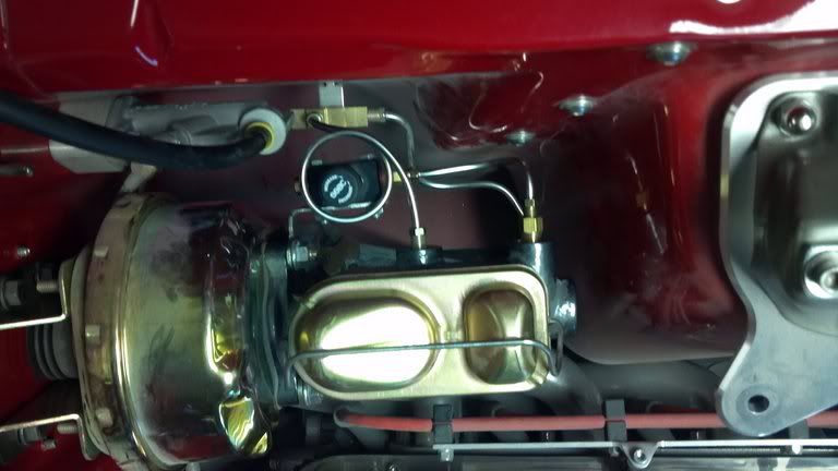

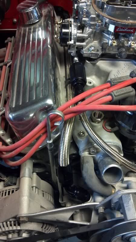

Ran the heater hoses, rigged up the throttle return spring, changed the position of the inlet on the fuel pump and worked on the brake lines a little.
