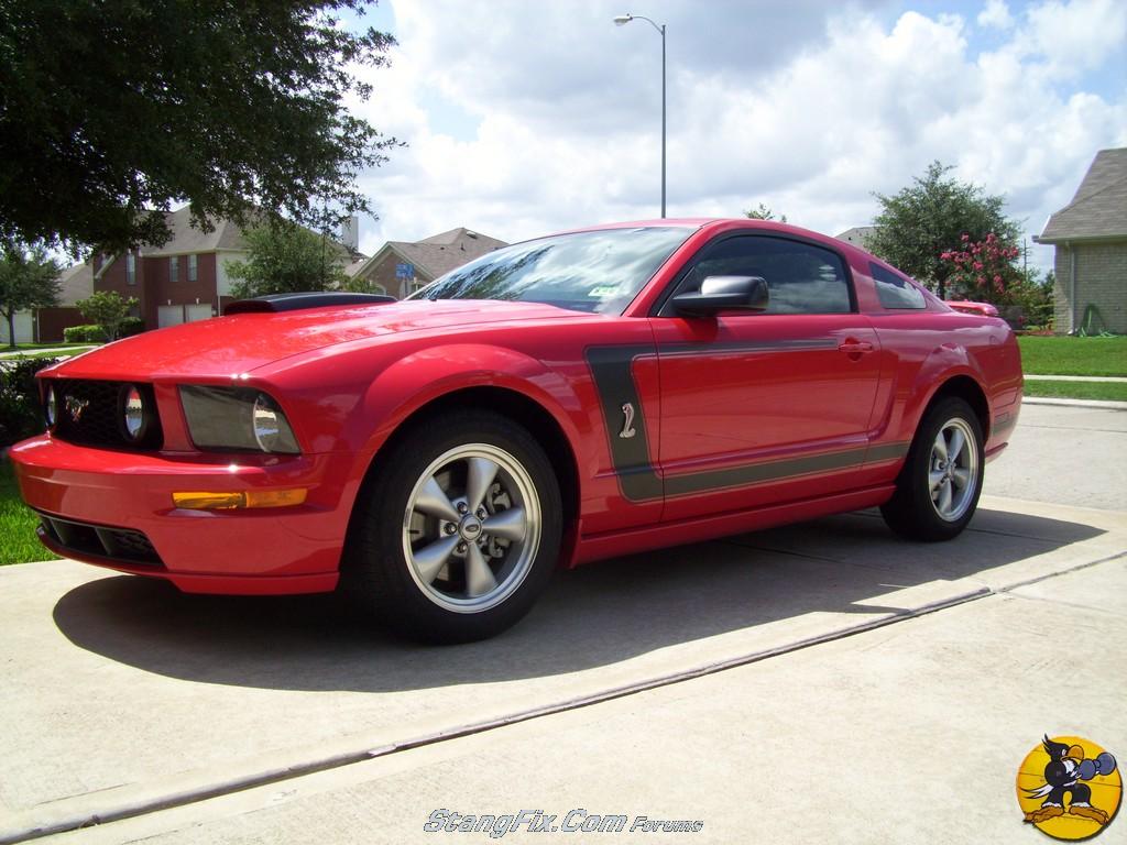

"Sluggo" said:
Not sure how they would fit but my take offs could be had pretty reasonably. Wheels and tires. IIRC 235/45/17 standard 08 GT silver bullets no curb rash need one center cap(missing blue oval) Tires have at least 50% tread left.
:confu something like those would fit on a 66 coupe?

"Kats66Pny" said:
Might look kinda nice on my 03 GT :roll
Kat I think the rims Sluggo posted are the same style rims Dave Sanborn has on his '66. Check out one of his sig pics in the WWSD board.
I'm not sure if they would or not. Did not measure the backspace but I recall it being an issue when I test fit them on the 69.
