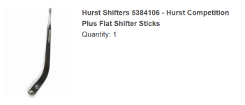

In response to your shifter post, I originally went with the "recommended" shifter from MDL when I went to a TKO600 in my 69 Mach 1 and it was too short and I really had to lean forward to shift. I had the correct ford 4spd in it before the TKO600 with a hurst and it was a comfortable shift for me. I did some research and their is a shifter for a 69 Camaro/Firebird that is lower and longer, plus it bends ever so slightly towards the driver. I switched to this one in my 69 Mach 1 and its perfect for me.
One thing you can do is make adapter plates to move the shifter. I have a set I'm not going to use that will move the shifter back 1.5" and allows adjustment up and down, you can have them if you want (provided I can find where I put them)
Thank you!
This is the shifter I used. I would be more than willing to pay for shipping plus if you find that adapter :)
Chris
I bought this multi position kit but I had to cut it to try to get clearance with my setup.
I think I cut off the top two holes on the right hand side of the MP bracket so instead of it tapering upward its now more of a rectangle. You can have them if you want, I'll cover the shipping if I can find them. You can always get some strap and make your own as well, thats what I did in my 03 cobra and ultimately my street rod to get the fit I wanted.
Thank you!
Chris
I believe this is the one.
I guess I was wrong about the lower part but its 2" further back towards you and leans 2" towards the driver.
