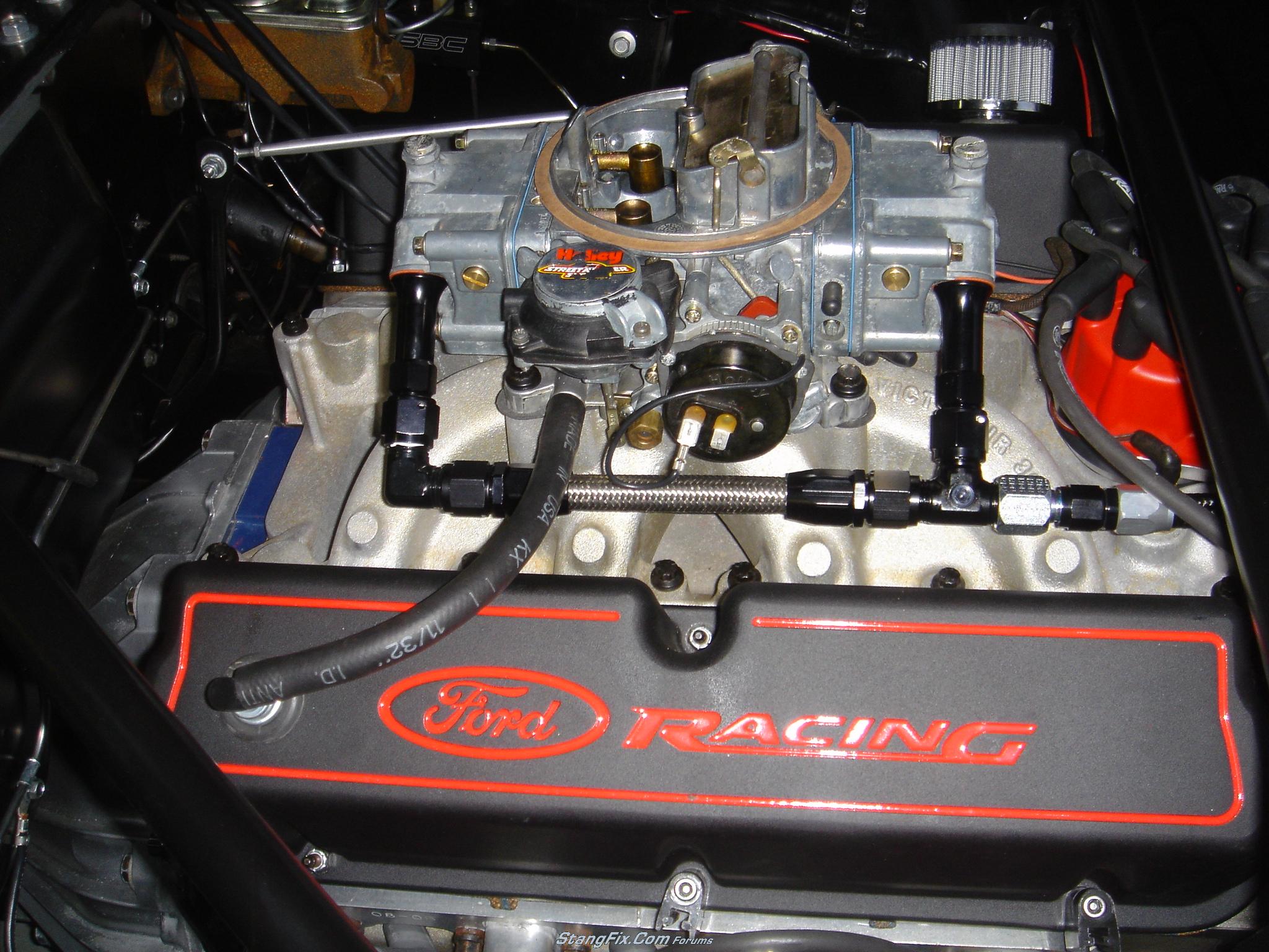

I just put the Shaun pieces on my car and I am totally pissed!!
If you're like me and are a real poser and put tall-ass-FE valvecovers on your 351 with billet adapters, then you're going to have clearance issues with the PCV valve.
:cry
I'm just kidding.....a short spacer and a taller bolt at the shock tower fixed the problem.
I'm with Sluggo....these things are BEAUTIFUL!
Best dress-up + functional addition to the engine compartment yet :10
Need to see pics of those valve covers and brace installed.
Ok, I'll give you some pics, but feel free to come by Sunday or Monday...just give a shout to make sure I'm not on a shakedown run.
Hate to burst your bubble, but that spacer will render your brace virtually useless. It will flex like crazy. You need to look for another solution (relocate your PCV valve, use shorter covers, etc.).
Thanks for bringing that up.
There is a significant bending moment on that bolt due to the increase in the vector distance over the original design.
To the extent that the bolt does not yield, the vector force from the shock tower is still being transferred into the firewall.
Bolts are designed to be strongest in tensile, not shear loads, so the sleeve is there not only as a spacer, but to transmit reactive forces into the shock tower plate.
All the engineering assumptions aside, maybe it will work and maybe it won't.
I guess you couldnt mount the firewall piece above the seam rather than below it I doubt hood would close. I'll see if I have a picture of my PCV, it seems a lot lower than yours.
