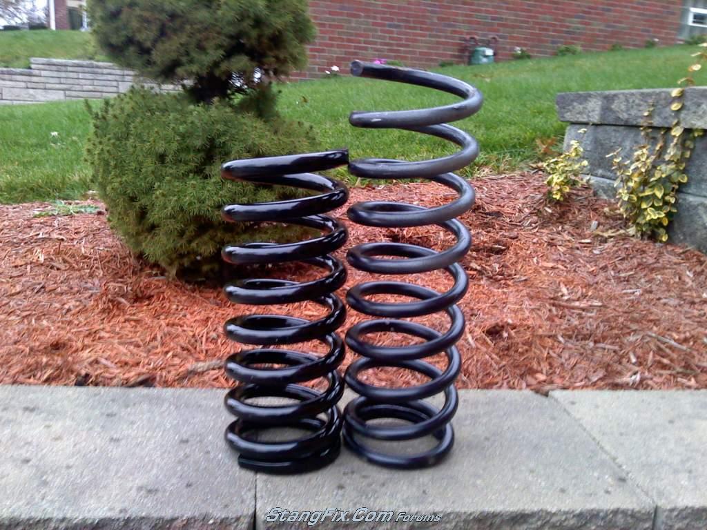

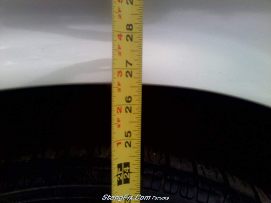

Finally got a chance to swap my springs out.

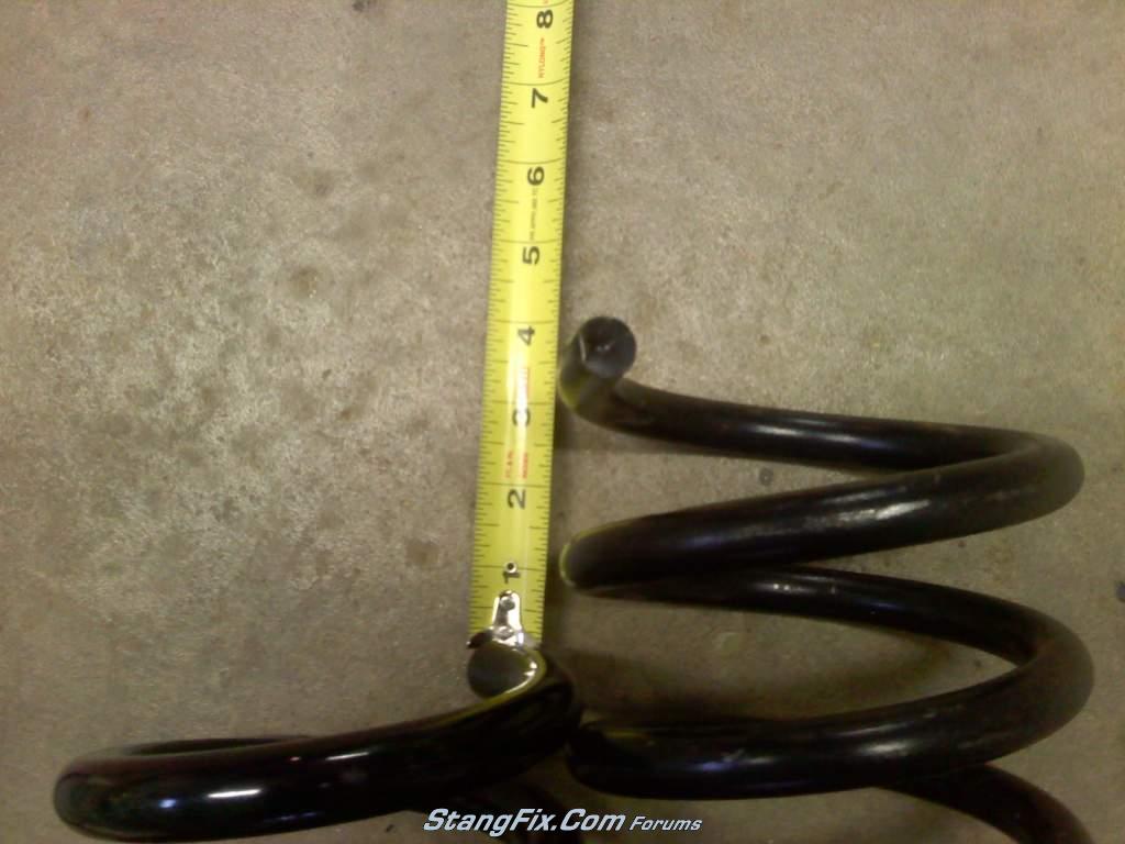

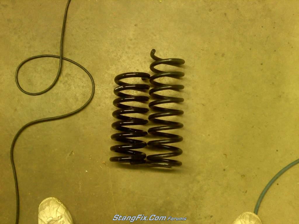

Stock height vs. 620# Grab a track.
There is 4 inches difference between the springs. So i decided to install them as is. I didn't cut anything off of the coils.

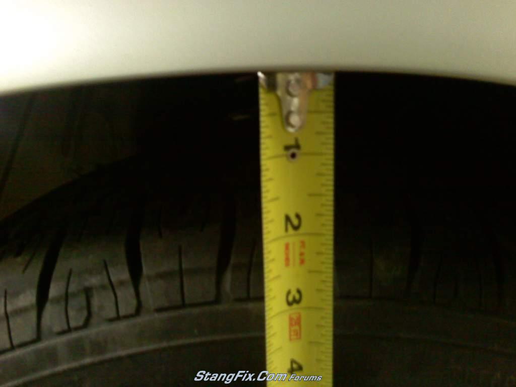

A picture of the fender height before installation (With stock height Springs).

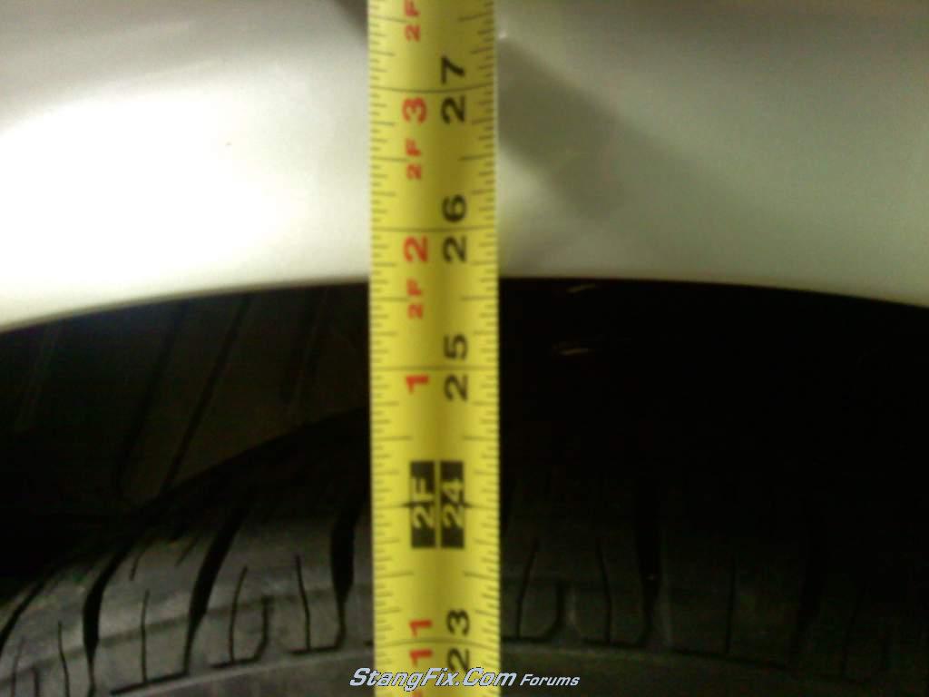

A pic with the 620#
Almost 1 inch exactly lower in ride height.

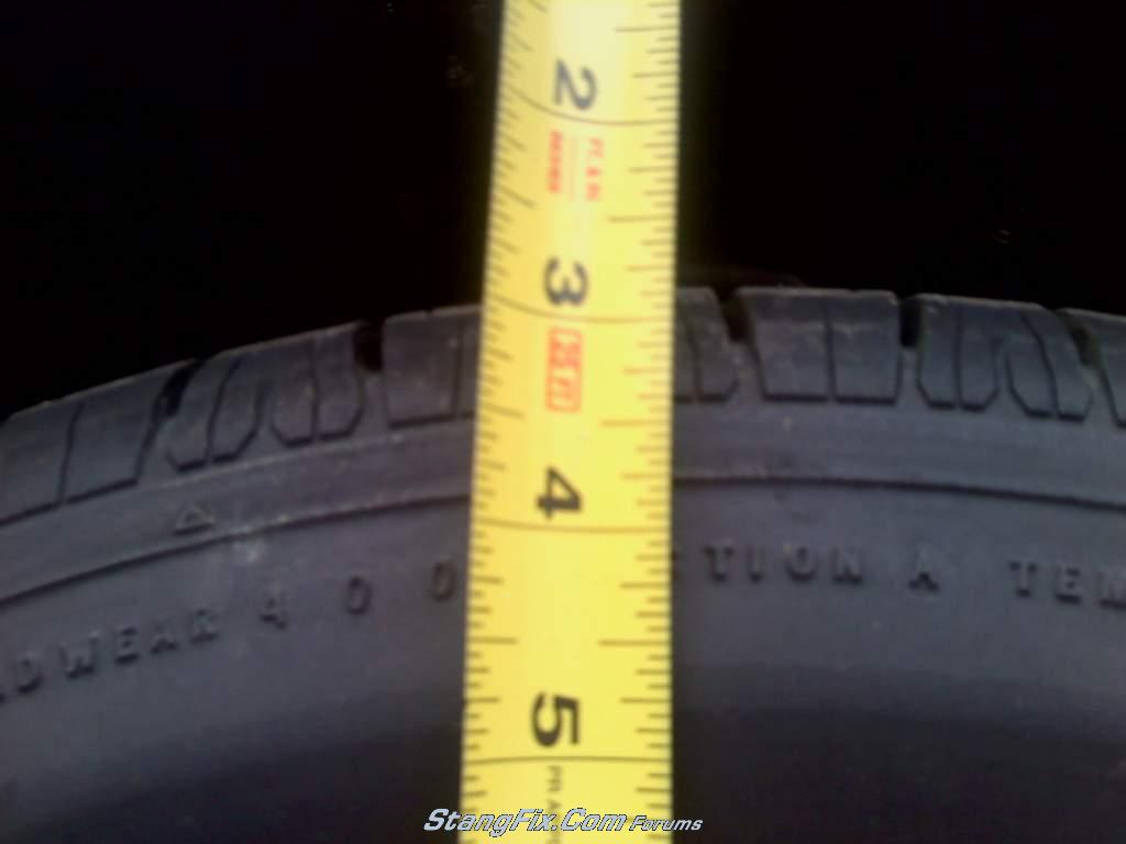

From the fender to the top of the tire:
Before
After

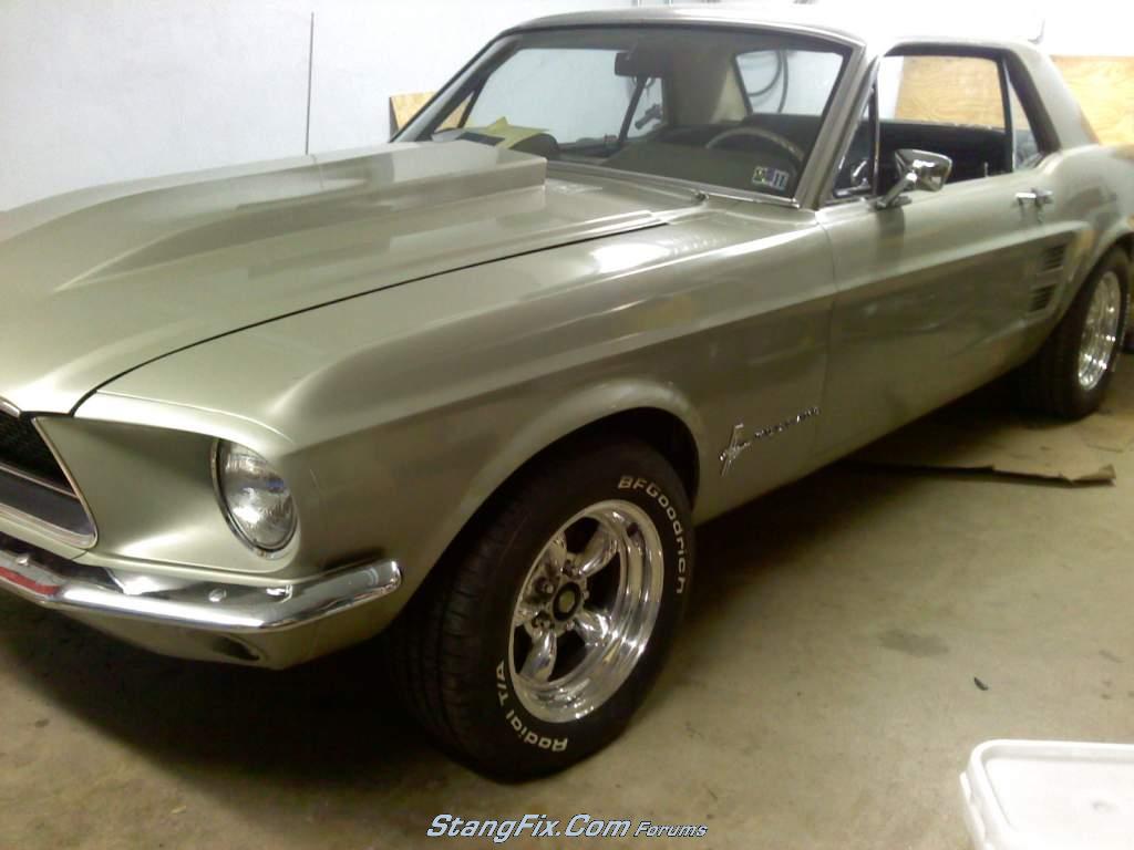

The best i could do for a side shot as the weather had turned Nasty.
I'm a little disappointed because i was hoping they would drop the front even further. I guess ill leave it be for now, and maybe come spring if it has not settled any (I am doubtful it will) i will trim some off the coils.
At least now I dont have to worry about scrapping the roof off of my garage door pulling the car in and out.

Got the car out today, put about 15 miles on it, And you guys were right. when i got home and back in the garage, it looks like the coil swap made the front fall a total of almost 2 inches. Im going to keep it like this for a while. Way better look then how it used to be. Heres a pic i took while i was out!
For comparison, heres where it was before the swap!
