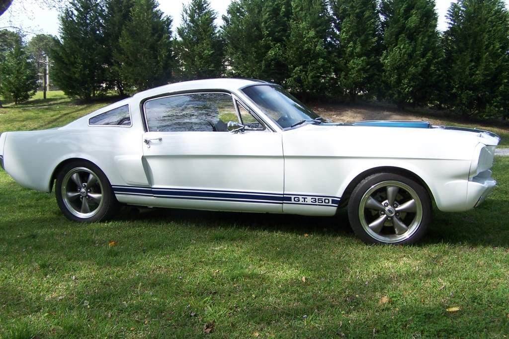

On the front I am running 1" drop springs w/1" Shelby drop, OT designed built by me roller spring perches. 17x8" SN95 mustang rims, w/ 245/45/17's. Rear is 5 leaf Mid-eye springs, soon to be Maier racing adjustable panhard bar. 17x10.5" SN95 mustang rims, w 315/35/17's. Not sure if I want to get the rear a little lower yet though. I'm running the Vintage Venom Cobra brake kit also.

Now THAT is how a Grabber's supposed to look :pep
+1 :wstup Beautiful Car Grabber70Mach.
