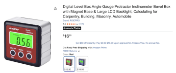

I still think you should remove the coilovers, set the spindles at ride height, and do it the easy way with a $20 angle finder. Caster is simply the tilt of the spindle front to rear when the wheels are going straight. Camber is the angle on flange of your wheel hub when it is perpendicular to the car. No rocket science involved.
Something like this,
and the toe plates will get you a decent alignment
