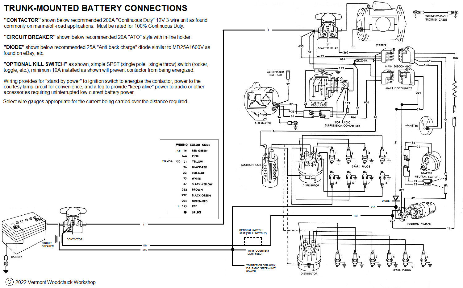

Trunk-Mounted Battery Installation Wiring Diagram
Trunk-Mounted Battery Installation Wiring Diagram 0
No permission to download
How to wire your trunk-mounted battery to be properly isolated, in case of damage/collision while allowing your courtesy lights & radio presets to remain active, etc. Remember! You need GROUND CABLES from the battery to the chassis and from the ENGINE to the chassis of a gauge apporpriate for the AMP load of the circuit. I recommend gauges no less than the positive battery cable.
