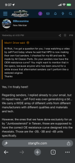

FWIW: For my 69 with 20 gallon w/o low warning light. I have tried several reproduction fuel sending units and had even had one C9WY-9275-A rebuilt by Basore. None are/were accurate. Just learned of a new and improved NPD sender that may be accurate. Anyone tried one? Brian

The repro stuff is hit or miss. Mine was a miss. Purchased through NPD but I'm not blaming them for the issue.
Ended up with a rebuilt OEM Ford unit. Works great.
