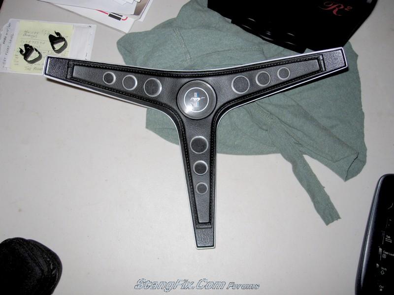

If anyone is thinking about restoring vinyl interior pieces I can recommend some SEM products. Don't know how it would hold up on something like a seat, but here's what I used when I finally got around to doing my steering wheel pad:
SEM Vinyl Prep (38343)
SEM Color Coat (15013 - Landau Black)
For the plastic I just used some Satin Krylon Fusion for the black and good old Ford Argent (Seymour T-19000-1) for the silver trim. I left the aluminum rings natural.
Didn't turn out half bad considering who was doing the work
Now all I need is a new center emblem.
And a horn pad...
And a rimblow switch...
And a restoration on the wheel itself...
