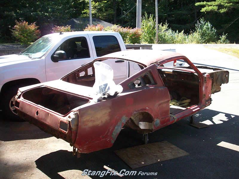

This was a complete car when I got it. I specifically was looking for the nastiest complete car that I could find. Wanted to get all the misc. brackets and parts, etc... I planned on doing a complete rebuild, so didn't want to spand a penny more than I had to. Was looking at $12K drivers at the time, that had rotten floors and would still need everthing redone or replaced (original interiors, etc...)
Found this in maine, for $1800 with a 68 302. Hadn't been driven in 20 years, but was driven alot up till then (in maine). So as you can imaging, the body was pretty much gone... More could have been saved than I kept, but It was actually a pretty easy process building it from new parts like Ford did rather than trying to cut out and piece in one piece at a time (but remember, I had experienced help)...
"65-408" said:
I had a post on the shell build a while back. That was done last fall with a past co-worker of mine that now runs muscle car metal in seabrook NH. he has been building 1st gen camaros from scratch for many years and is a dynacorn distributor. Got the parts through him (all dynacorn). Some were better than others, but generally all were great for the price. This was his first ford endeavor. We built it together and I learned a ton (he is way up the curve on build your own unibody techniques). we adapted his camaro jig... The shell was built in about 2 months, probably 200ish man hours (including alot of head scratchin and figurin time...).
It has taken me the rest of the year to get the body panels fit (2 small boys, no time)... while working on random mechanical things at the same time, steering, suspension, rear...
