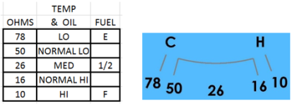

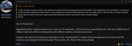

The problem with aftermarket senders is that they don't match the resistance curve that Ford wanted. Yours are in the high-low range, but my 69 sender gets 20.2 ohms for 10 gallons in a 20 gallon tank, and it works perfectly.
I can't really judge if you have a problem with the IVR. The originals are better than an aftermarket 5vdc regulator, and you could find a used IVR on Ebay. The original IVRs will get your gauges to their operating positions quicker than the aftermarket regulators. That's probably only important when watching the oil pressure while starting (which I always do). The OEM IVRs don't actually start to pulse until heating up, then after the first pulse the subsequence pulses come quicker. The first pulse can be up to around 44 seconds in some conditions- it depends on the resistance of all the senders, as they are in parallel.
Your problem sounds like it may be the float arm isn't adjusted for proper travel in the up position. You want 10 ohms when the tank is full, and 73 ohms when empty. If you get that worked out, then you could use the Meter Match device mentioned earlier to get 1/2 tank where you want it.
