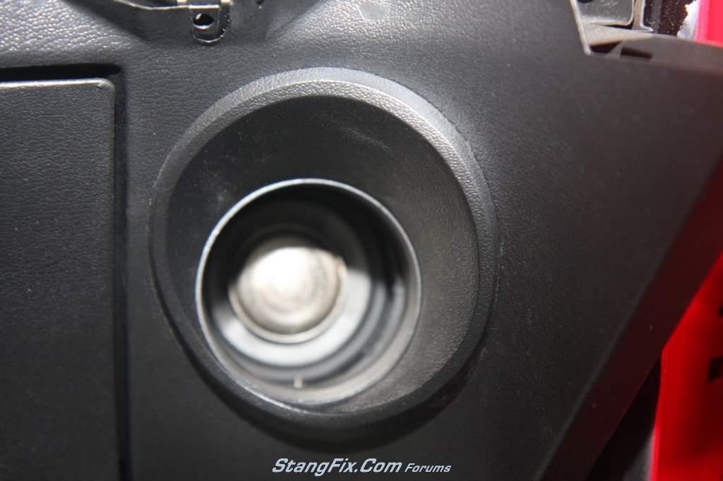

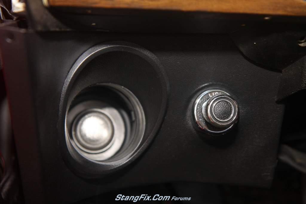

The lower dash of my current project was hacked by a previous owner with miscellaneous holes... So I used the lower dash from my parts car - however the parts car had AC and my car does not. I thought about adding AC to my project, but that was not in keeping with my theme for the car, so I later investigated converting the car to the "Power ventilation" option. I was unable to procure all the parts for this, and had just about given up and resigned myself to hacking home made ductwork when my son said: "Hey, I bet you could mount your speakers in there".

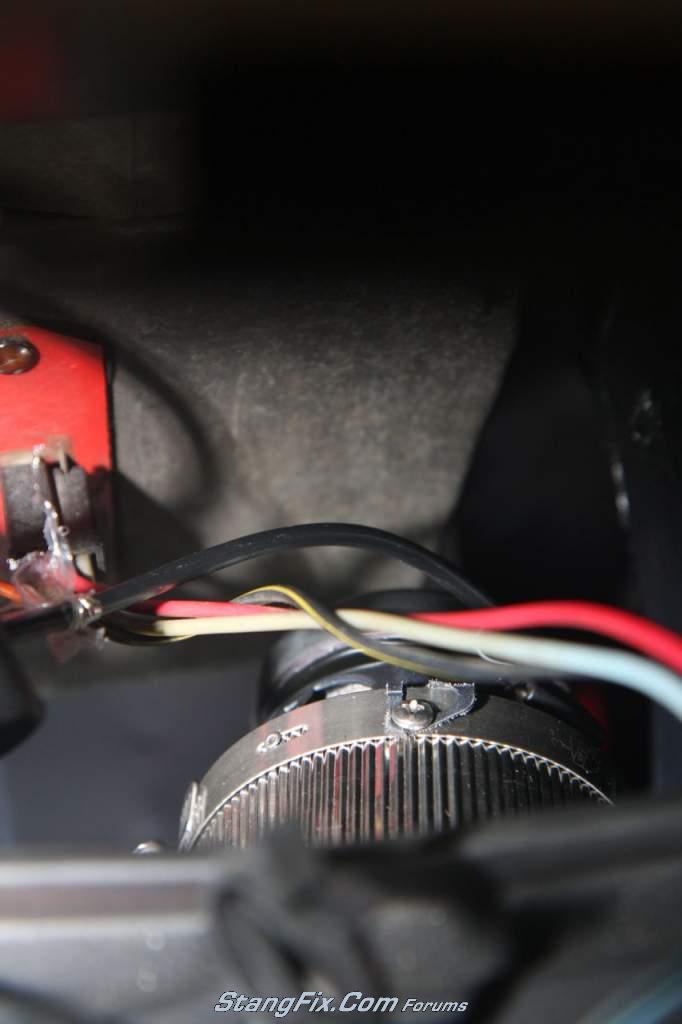

I had not put the flow deflectors in when these pictures were taken, but it turns out that this setup works perfectly with 3 1/2 inch speakers. I used 3 inch neoprene pipe couplers with stainless steel bands and clamps to mount the speakers.
What do you guys think? I kind of like it!

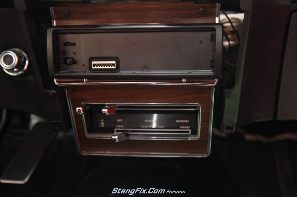

Head unit:
