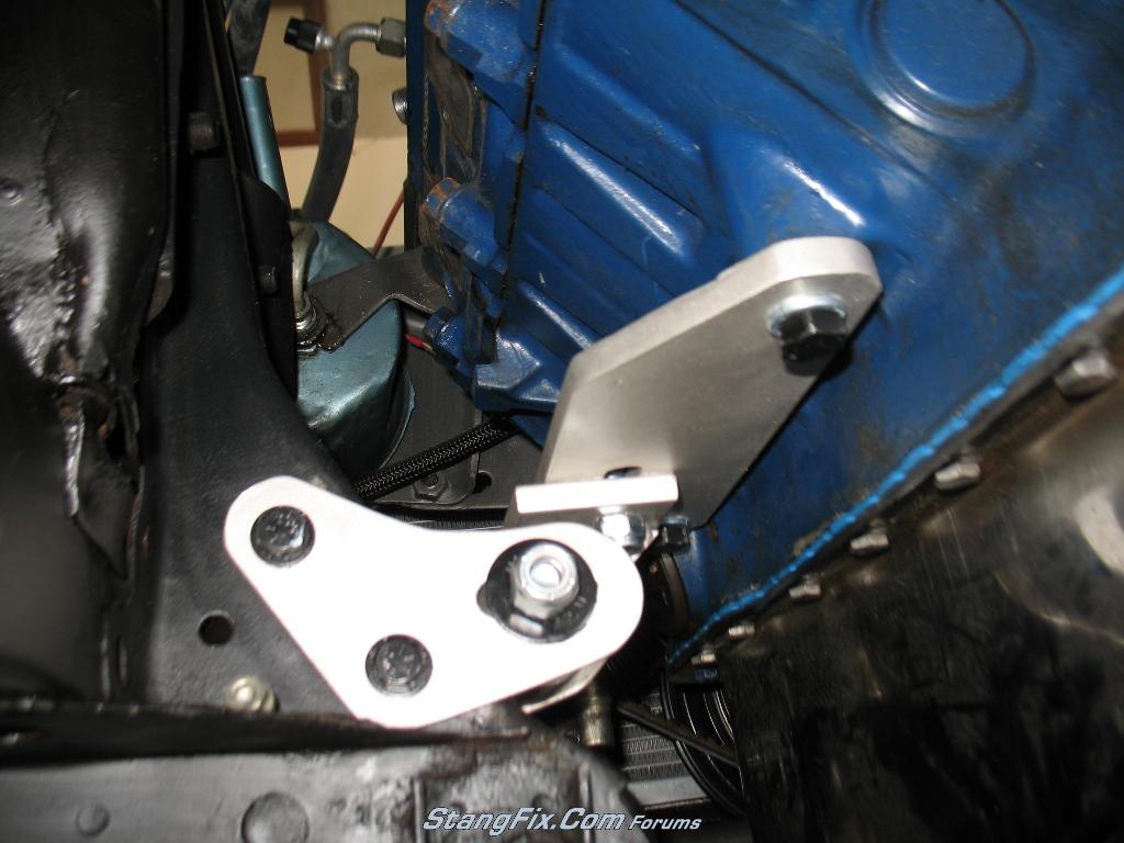

My JBA 351W headers ended up contacting my TCP motor mount on the drivers side. If you can see in this picture, the front cylinder pipe drops almost straight down like it is on a mission to contact the mount. It could have easily turned rearwards earlier and not contacted anything. I did some grinding on the mount but also had to clearance that pipe with heat and a BFH. Still touches now and then at low idle and drives me nuts. I wonder if you know whether your set has more room than TCP?

What part of the mount was interfering? Top plate? I'd have to take a look under the car now that I have my Hooker headers installed to see if they come anywhere near the mounts. These are the only two pics I have of them installed and they don't have the headers installed at the time of pics.
