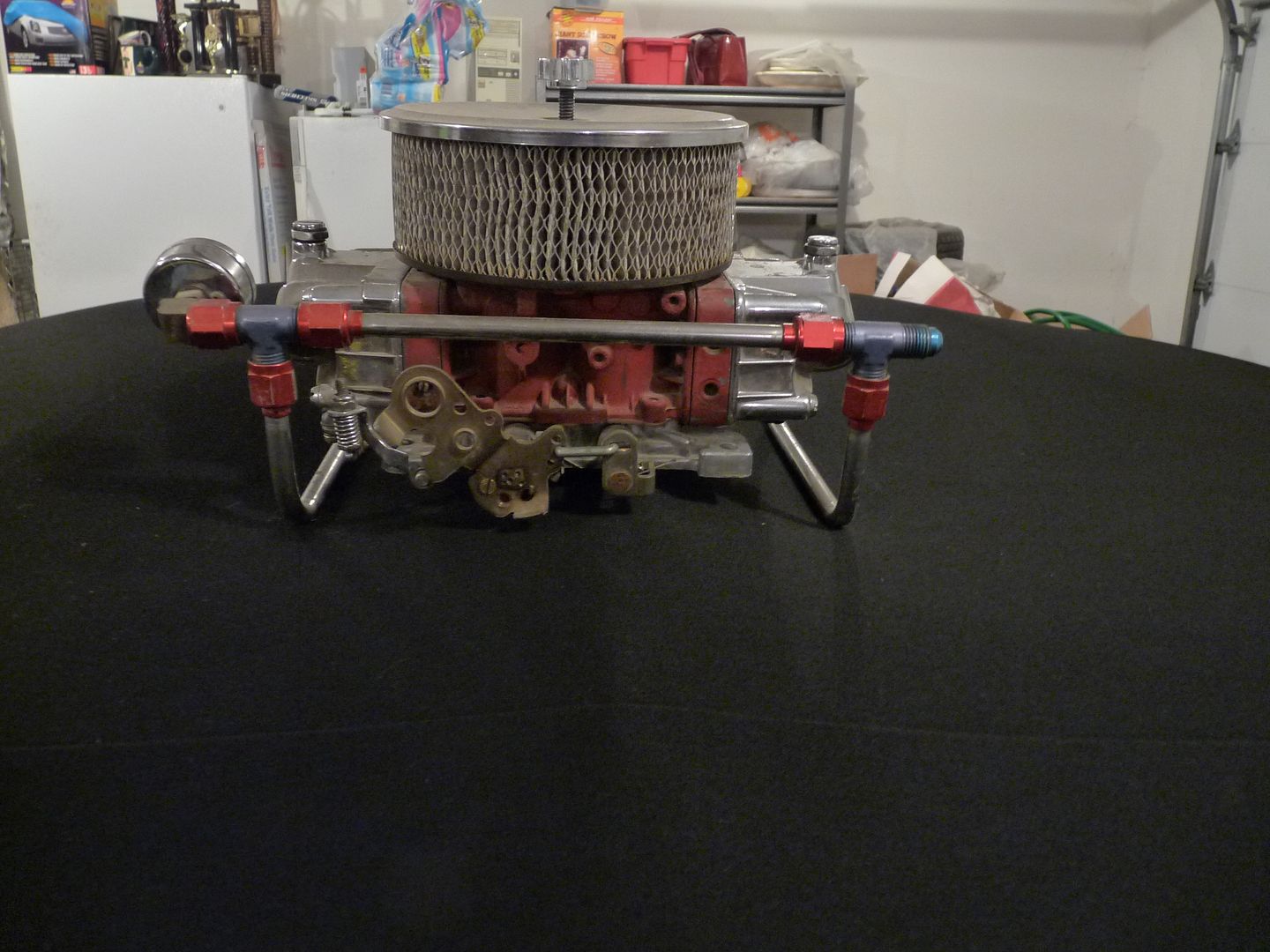

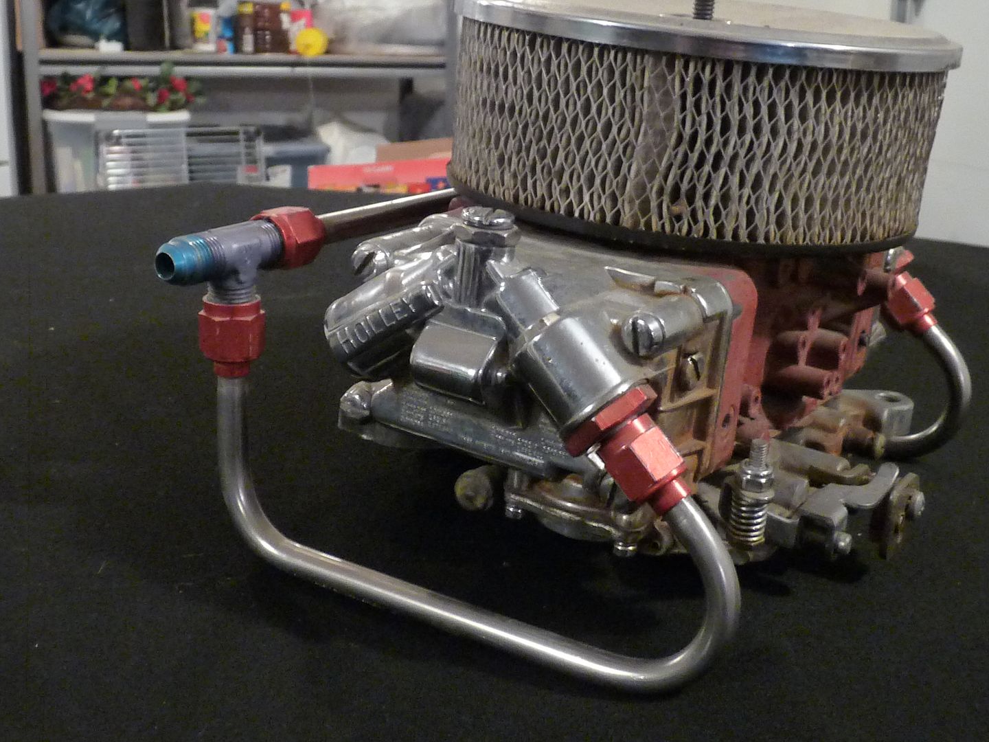

Thanks Guys I won't need a 4 port regulator but only a two outlet -6AN & a halfinch inlet. The plumbing on my carbs are fit for a 06an 3/8 AN fitting.. I will have pictures'
The first pictures are of one of my 600s dp with the side saddle carb plumbing.They are dirty but you can see where the female 3/8s AN would screw right on to te 3/8 flare t..

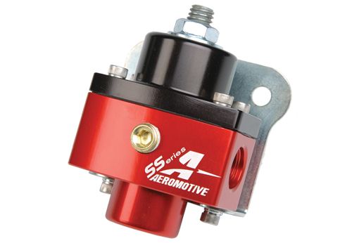

Last one is of the correct regulator. it is adjustable from 5-12 lbs & 1/8th NPT guage port & 06 inlet & 06 outlets.
