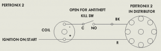

8. Kill Switches for other ignition systems: here are a few other popular ignition systems and how to disable them.
This would work for a Pertronix 1 as well. When I showed the example in #6 above to Pertronix, they were sure it would disable the car, but thought it may also damage the Pertronix module. They offered this solution instead:
and another
and another
