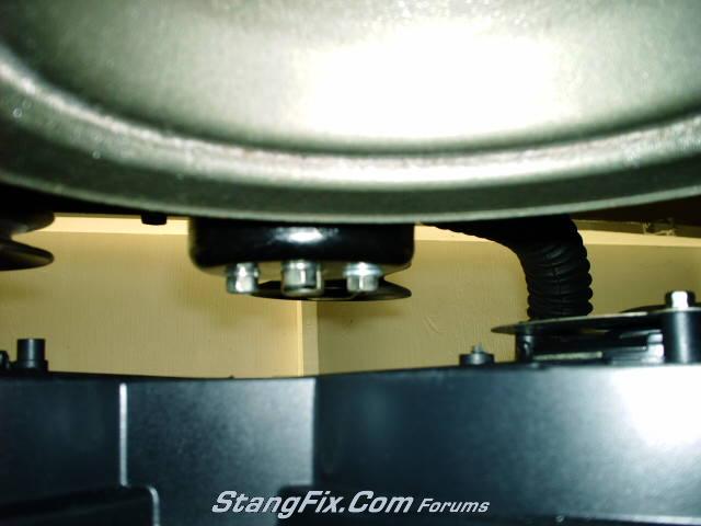

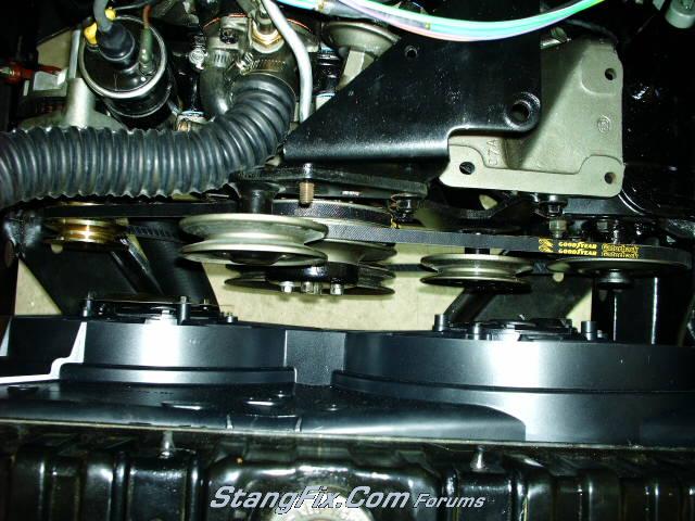

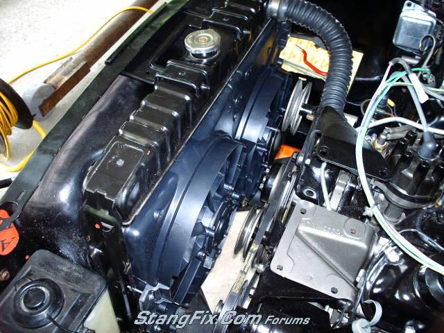

The other thing that is a larger issue is the idler pulley for the water pump sticks out about 1/2" -3/4" further than the old mechanical water pump. Now the radiator and fan are in the way. I have a step brother that is in the business of making books for parts stores that cross references radiators and has quite a few connections in the biz. He is getting me in touch with a friend that can help me address this problem. I think I will end up with a larger radiator and run two smaller fans.
