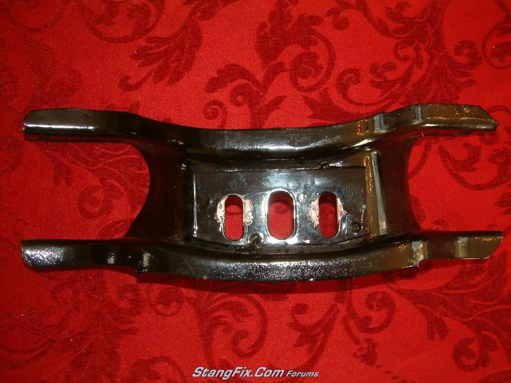

As far as I can remember it came from my 69 mustang when it has a 302 and a FMX in it at the time. But it could be anything. Front the top it is an “H� pattern, 3 slots in the middle with a reinforcement plate spot welded where the 3 slots are. It also has a large “R� stamped on it.

Factory spot welds, and it looks all factory.
Definitely not an FMX from what I remember mine looking like. It's mounting tabs converged together on one side while on the other side had the H-shape. That one looks more like the C4/4spd crossmember except those had two slots and no reinforcement plate.

This is correct. This is definitely what mine looks like.

Looks like a '69/'70 C4 cross member, to me. The difference from the '65/'66, is that the early years had a fulcrum point for the parking brake on it, that isn't needed in '69/'70. IIRC, the '67/'68 is like the '65'/'66, but I can't remember on them.
