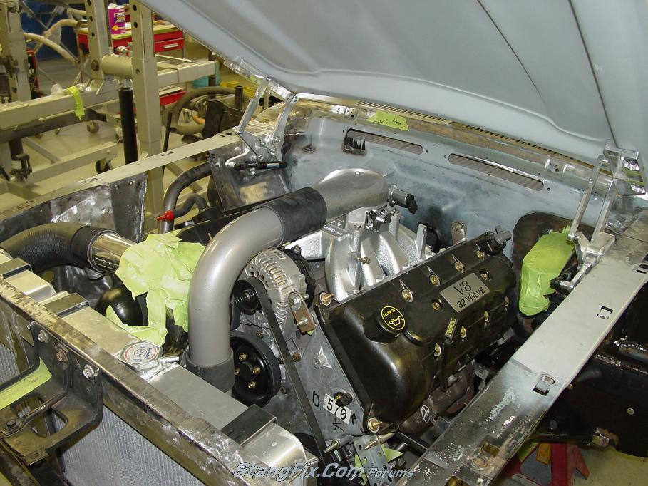

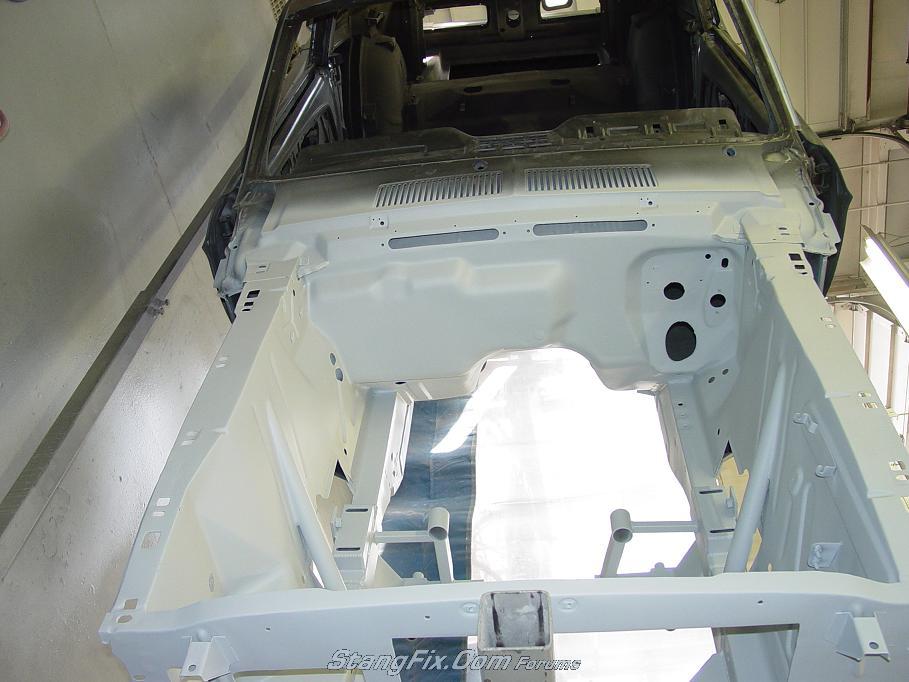

Tarafied, Yea I didn't realy care to get into it with Mr. Sanborn, The unique cars had a cooling problem
because the rad was to small (not sufficient enouph) to cool the heated up supercharged engine's .
More HP More cooling needed, We did 2 BB cars 500/525hp with griffen rads and had 2 cooling problems.
Redisigned and change out the rads and Whala problem gone.................... The holes in the cowel cerntly
does not hurt anything, but thats my opinion..
Gene www.gtechcars.com
Gene,
My 429 is no big HP monster but I have an older repop 4 core copper/brass radiator and an electric pusher fan. I think the cowl vents helped my combo in traffic. I had tried a few things prior like using water wetter and only 15% antifreeze (it helped), but I agree a better cooling system is the best way to approach it. I just gave it a try because it was easy to cut the holes before the Power Tour and it's been working but an aluminum radiator is in the future!
I like the screen you have used. I actually drilled holes with a hole saw rather than a big hole/slot. Do you think the screen would look okay with holes? (5 per side)

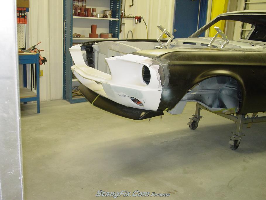

It will be Shelby nose with the bumper shaved and a spoiler on the bottom

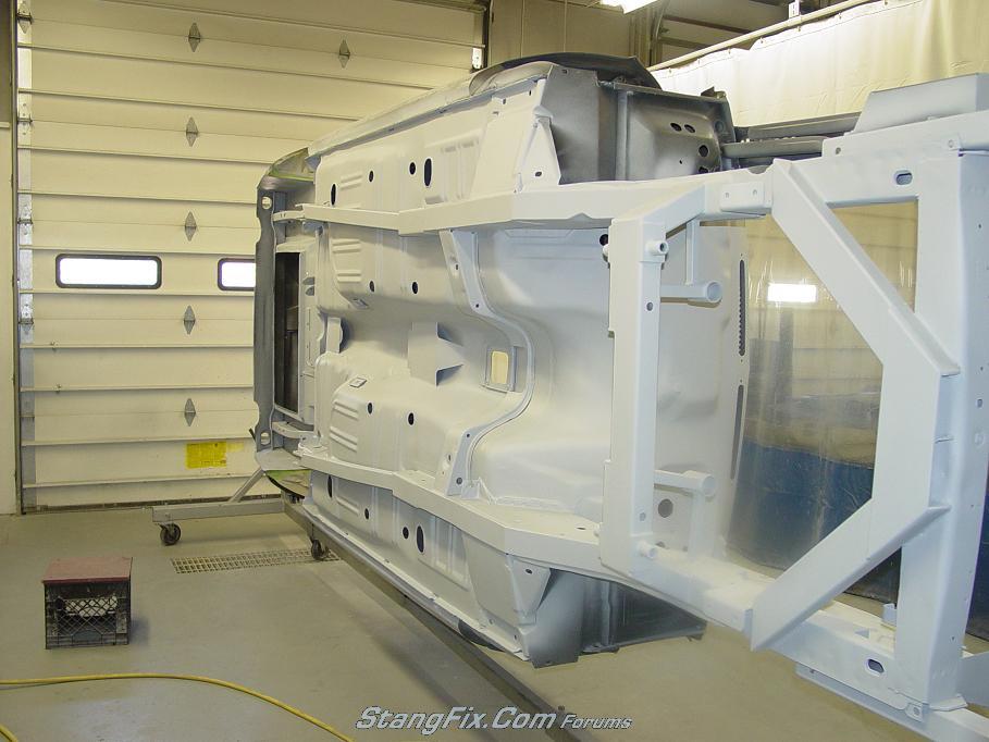

Happy Holidays Everyone! Here are some more pictures to enjoy!
Engine Mach Up
Trans

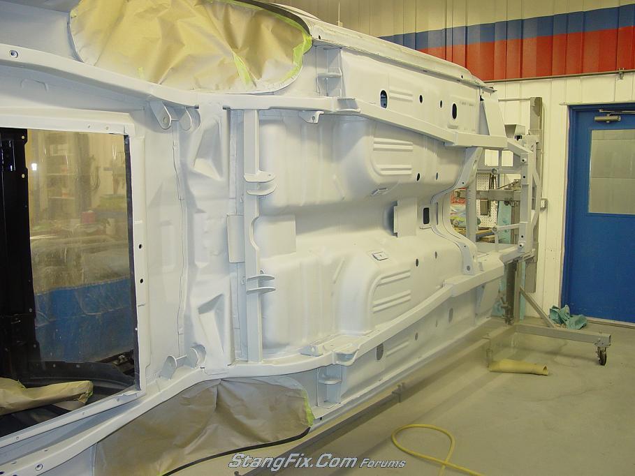

Starting Body Work
[admin]I fixed your post, you had added the pictures as links and not images[/admin]
Here is another update with more progress photos for you all. Enjoy!
:) Holly

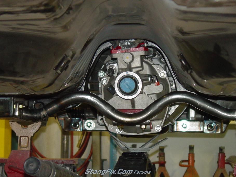

The I.R.S.
Wheels
Front Nose (Bumper Shaved)
