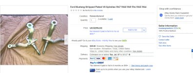

JUL 2, 2020:
Ok, well it has been a while. The build is going slow. I had bought spindles from scott drake and subsequently received the recall notice. I was already not happy because I had to machine them to take the big disk brakes - as they had a different shape back plate.
I thought I would just get a set of factory spindles and get them finished. I also have heard unconfirmed reports of problems with the replacement run of the SD spindles.
I found an ebay seller that was selling chemically stripped and plated spindles, so I ordered from him.
What an ordeal. The guy is either completely dishonest or utterly insane.
I just had my first negative experience on ebay after 20+ years of buying and selling.
Beware MUSTANGMANBOB - a seller on ebay with over 5600 feedbacks and a 100% rating.
The cliff notes - ordered a set of plated and painted spindles. Received a set of junkyard pulled spindles that had not even been cleaned let alone plated and (in his words) detail painted.
The maddening/insane part is - mustangmanbob INSISTS - even when confronted with photographic evidence - that the parts are as described. It feels like I am in the Dead Parrot Skit in Monty Python. So - Caveat Emptor with this clown my friends. It's pretty rare to encounter someone who will carry the lie straight in the face of prima facia evidence to the contrary, so this guy is now my project.
For your entertainment - The AD vs what was delivered:
fun times. We will see what ebay does.
