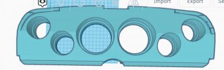

Where did you get a 200 mph speedo?! Could be a challenge seeing your speed with the stock wheel design as the needle will be spending most its time laying off to the left (perhaps hidden behind the wheel's horizontal spoke). For that same reason you may want to swap the locations of the fuel and the oil pressure gauges. Personally I'd rather have the oil be front and center.
It a chinese set of gauges i got cheap, GPS setup........ I have a couple other configs and ive also changed me wheel out to a wood wheel.
Ive also have a couple different designs for this bezel so :)

Well ive been BUSY!!!! My Chinese gauges were a very custom fit and since the TACH wouldnt work, i ordered a VEETHREE Tach, that I know would but it wouldnt fit in my cluster..... So I just printed my different design cluster made for a more standard size Gauge setup

Redesiging more....Working on getting the best viewing angle to see all gauges easily. Lowered the Middle 10mm, reaaranged the outside gauges, and tilted the gauges about 5 degrees forward. Printing one out now for testing purposes. 341083953_1266141040953141_5922024917711065430_n.jpg
Redesiging more....Working on getting the best viewing angle to see all gauges easily. Lowered the Middle 10mm, reaaranged the outside gauges, and tilted the gauges about 5 degrees forward. Printing one out now for testing purposes. View attachment 35178

Haha yeah, i cant stop but this is more about accessibility. The small guages are hard to read from my standard sitting position and even the speedo is slightly... So moving things around is about getting the best viewing angle so i can easily read gauages while driving. I do agree though, Its a never ending rabbit hole where I think something will work and it doesnt quiet pan out...But even though im not in it for the "Show Car" end game, the unique cruiser will atleast make it to the Power Tour.....How far i take the Torino is a whole different story, but like all my cars, it has an end game of a nice cruiser as time/money allows.
