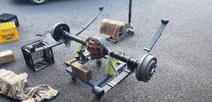

A buddy had most of the body work done and the project lost its momentum then sat a few years. We struck a deal later and I dragged it home.
I kept the foundation "correct" including the factory color and went for the day 2 theme with a few bolt-ons.
428 SCJ, PI Aluminum intake, Factory 735 Holley carb, slightly hotter cam, Headers, T-pan, electronic dist, and custom X pipe exhaust with Magnaflows. The stock iron intake and dual point dist are on the shelf along with the power steering set up - I've never liked PS in any Mustang I've owned. Dyno results were 445 HP & 495 TQ. Plenty of street power for a 4 spd and N-4:30 rear. (TKX in the future?)
