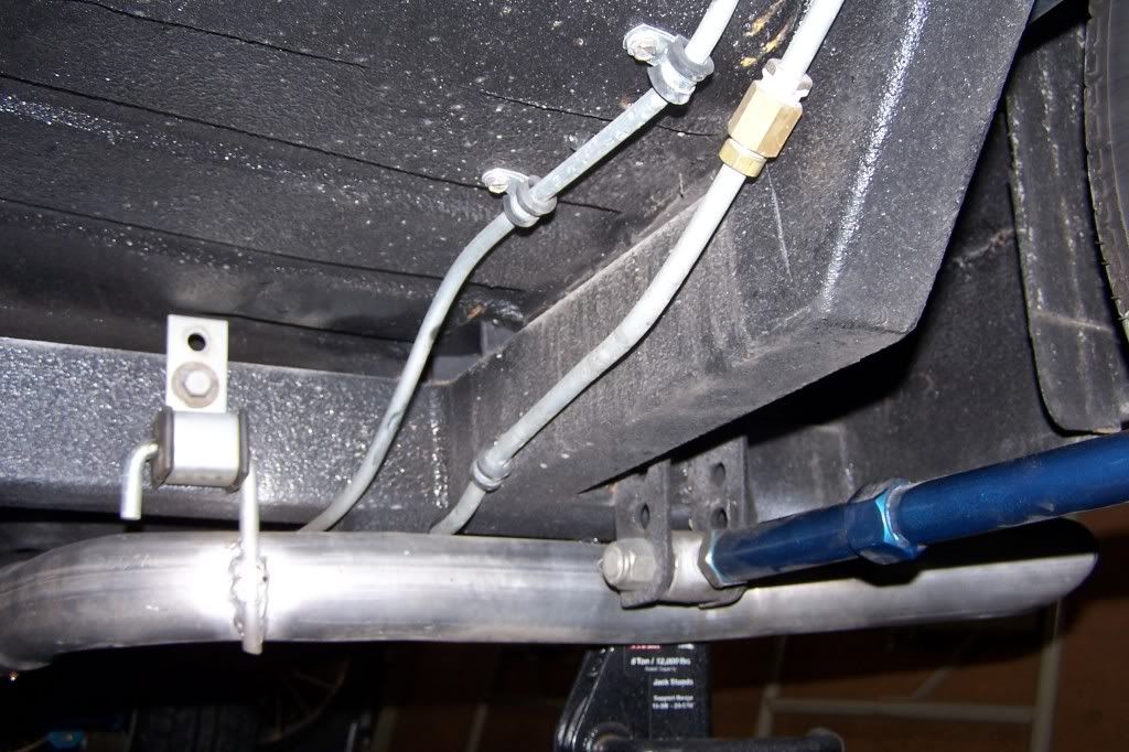

If you decide to section the length to make it install easier..... double flare the lines and install a joint in an appropriate location. As visible in this photo I ran a long length from the joint forward to the engine compartment and a shorter length from the joint back to the electric fuel pump. I suppose I could have ran one continuous legth, but it was just easier to work with two pieces.
I thought about that today Dave as I was looking at lines. Straight 6 foot pieces with fittings on each end were $9/piece. That meant coupling and cutting/flaring. Easier to install but decided to go with the 25' roll for $18. That gives me plenty to allow for a screw up or end up having extra line. If it gets to complicated I'll make two pieces. My goal is to have one continuous piece running to the bay and connect with rubber line to the fuel pump.
