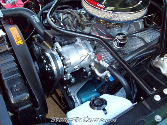

So far the kit seems to be well designed specifically to the Mustang, but there are still a couple areas with room for improvement. I don't care for their compressor mount, so I used the factory brackets and idler pulley with an adapter bracket. They also didn't provide a compressor belt or instructions for how to incorporate the compressor pulley into the existing pulley system. No extra pulleys, idlers, or brackets were provided other than the compressor mounting bracket. I bought a standard 68 A/C belt which worked just fine.

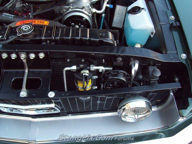

[size=small]Condenser and dryer

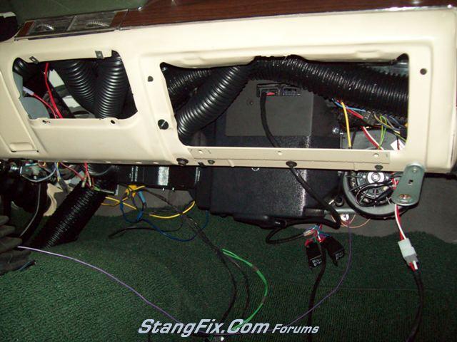

Evaporator under the dash. Need to clean up the wiring but that's just winding stuff up, zip tying it, and tucking it under nicely.

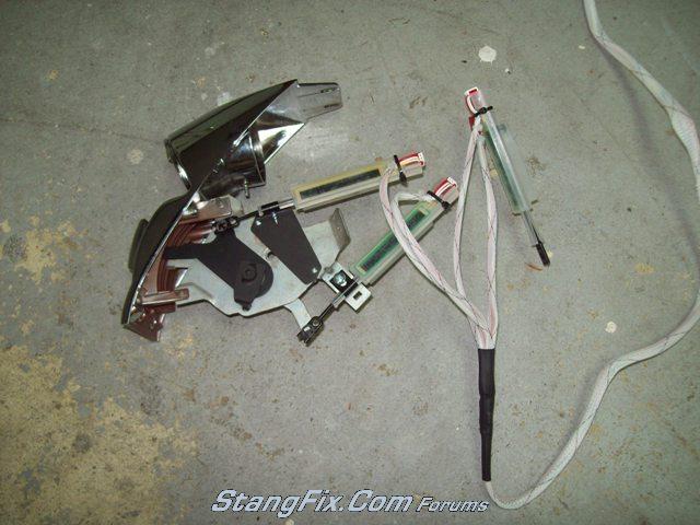

New controls. Install went very nice and easy, clear instructions. All controls electronic. Even the calibration of the control panel is electronic. Unfortunately they missed a lever on the initial package that was sent to me. I realized this over a weekend, called on Monday, and on Wednesday the missing part was in my mailbox. Good customer service so far.

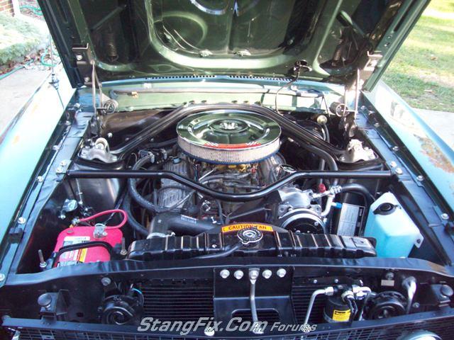

[size=small]Compressor and lines/hoses installed[/size]

[size=small]Evaporator with all the wires tucked away.

[size=small]Factory A/C control panel with new levers and variable resistors vice cables to control all the flapper doors.
