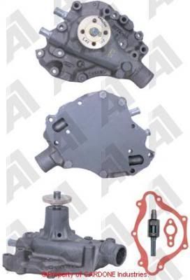

I replaced the water pump over the winter since I had the engine apart and it had 7 years on it. I could not find a replacement for the one I had, so I looked around and ended up getting a NAPA pump locally. It looked strange when I checked it over, dbl checked with the local guys about the rotation and they convinced me it was correct. Fast forward to the last 2 track days (only time on the road) and the car would run too hot after a few laps. I took it apart this morning and compared what I have to the chart below and I'd SWEAR that the pump is reverse rotation, NOT a std CW rotation.
It's a LH inlet mounting to the stock 289 cover.
What do you all think?
Here's the chart showing my cover in the upper left.
Here a pic of the pump.
