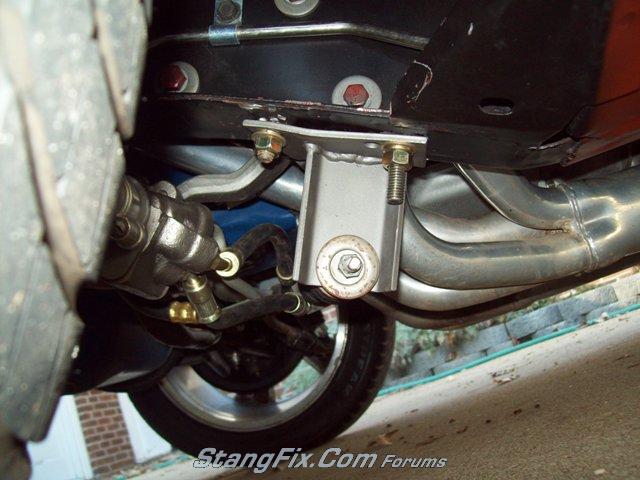

Next up I still need to weld a nut into the underside of the frame for the power steering drop bracket and the car is ready for the road again, with one of the first trips being to the a/c shop for a 134A charge. Then some more shake down, assessment, and the ensuing follow-on projects.

Welded up the frame, power steering bracket is bolted back up.

[font=verdana, arial, helvetica, sans-serif]Power steering drop bracket.[/font]
