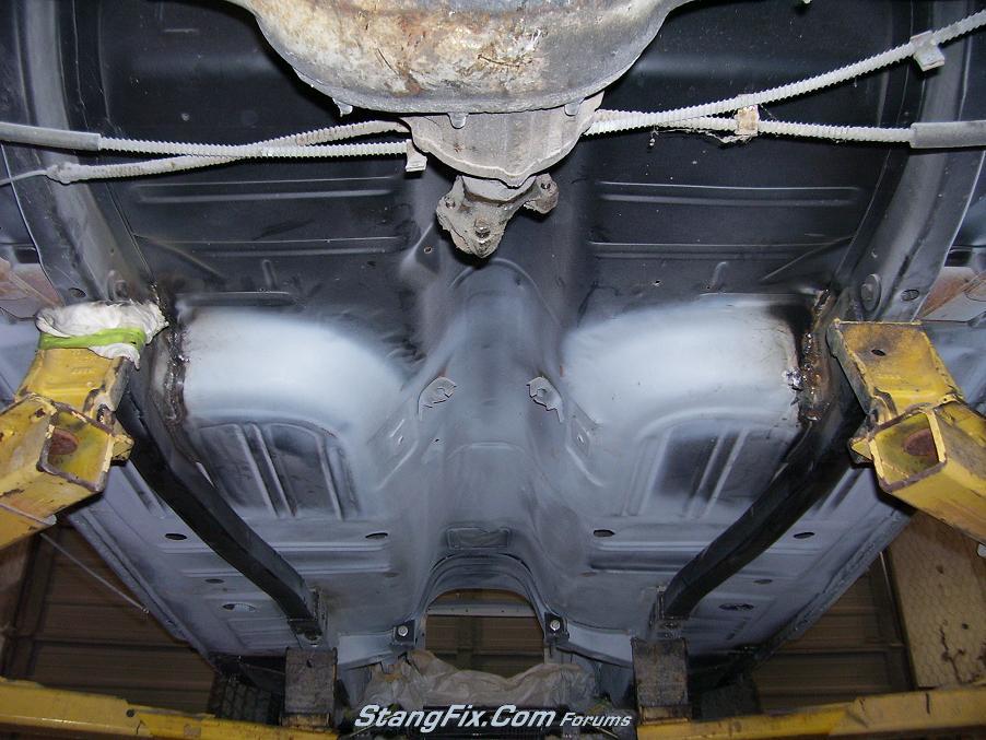

Well I've been slowly working on the 65 fastback getting it ready for paint. We got the jambs and engine compartment almost ready. Then I decided to put it up on the lift and start prepping under the car. I took a look and decided to do more welding underneath, places I think the factory should have welded more. I hope to have this completed tomorrow and then really prep the undercarriage for paint. I know this probably didn't happen because I don't have pics, but I'll try to get some tomorrow for proof!

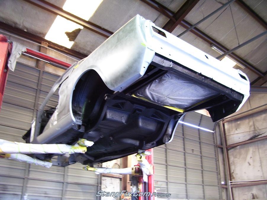

Ok, finally got the underside of the car and the inner fender area shot with bedliner today. I also decided to smooth all of the pinchwelds around the bottom of the car. That made a huge difference. I'll still black out the pinchwelds, it will just look much better.

Looks good, 2 questions:
1. when you say smooth the pinch welds, this is grinding and filling?
2. what do you use for bedliner product?
Thanks,
Jeff
Yes, the pinchwelds are still there, I just ground them, smoothed over them with a skim coat of filler, and blocked sanded them smooth. I have used lots of bedliner products through the years. The best I have found for under a car is U-Pol Raptor liner. It dries hard, but still flexes enough so it doesn't crack. Some of the other bedliner products stay too "rubbery" for me.
