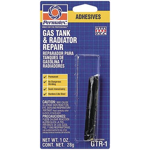

This stuff works good on gas tanks to fix holes and such. You could wad some over the fitting till you use up the fuel.
