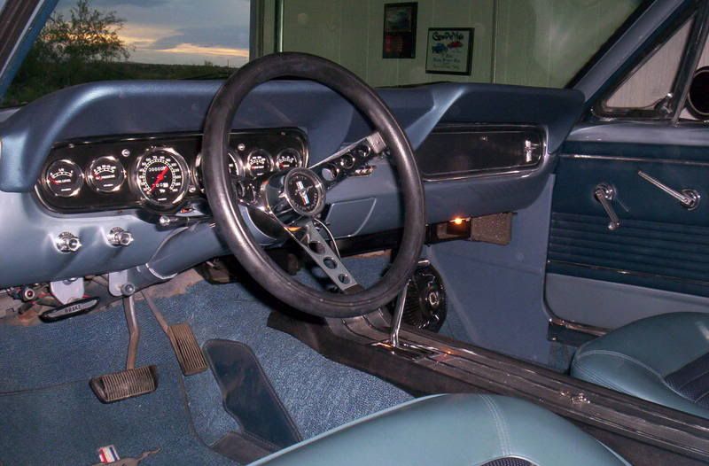

From a "modified" perspective, you can paint the entire dash panel (ashtray and steering column included) the same as the exterior body color. I did this with my '66. I also painted the interior side of the A pillars with body color/paint.

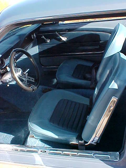

AZPete...have any pictures?
Sure, some interior shots plus one of the matching color under the hood. I would do it again if I have another car painted completely. I might leave the firewall under the hood black for a different look......
