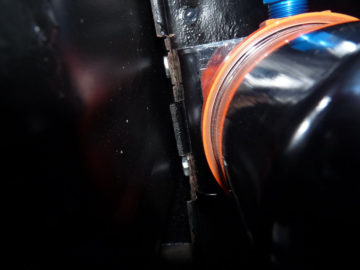

A word to those that follow. When installing an electric fuel pump, do not mount the bolts so they are blocked by the installation of the fuel tank. Ended up having to wedge a screwdriver in the limited work area to lock the bolt head so I could get it tight. I did nor feel like draining the gas and removing the tank. The pump is mounted on the flange that drops down along the tank when it is in place between the tank and the rearend.
AZpete I have been thinking about installing a electric pump and was wondering do you have a shut off for the pump incase you get in a accident or something that would shut the pump off? Also do you run the power wire from the ignition down to the pump? When I installed my fuel filter in the back I used a dremel and cut that lip that sticks out and bent it straight where I would have just enough room to get in there with a open end wrench if I ever needed to.Also is that a 110 gph pump? Do yu use a regulator? Thank U for your time.. I will post a few pictures..
The Holley Red is 97 GPH, no regulator but have an in line gauge near the carb. Constant 6-7 psi when running. I do not have a cutoff in case of an accident. It is wired from the ign. on power source thru a toggle switch for security. If I planned on keeping the car, I would have spent the time to remount the pump as you said. I was doing most of this in a parking lot so it was get it on the road....... Now, to get my back pain to leave again....
