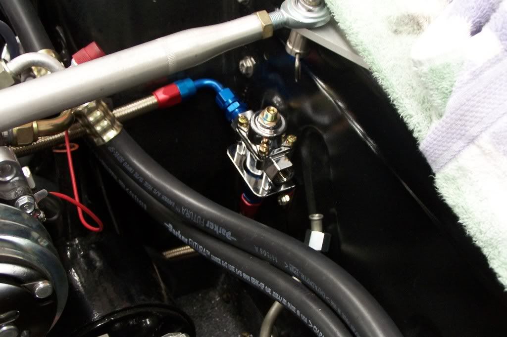

My car is EFI and would be different that what you'd need to use.
Here are a couple pictures of the FPR with guage in my sons carbuerated '68.
The reason I asked about the internally regulated fuel pressure of the Holley fuel pump Derek mentioned is that most carbuerator manufacturers recommend that fuel pressure be set to approx. 4 psi.
