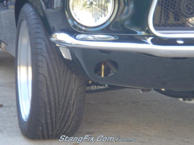

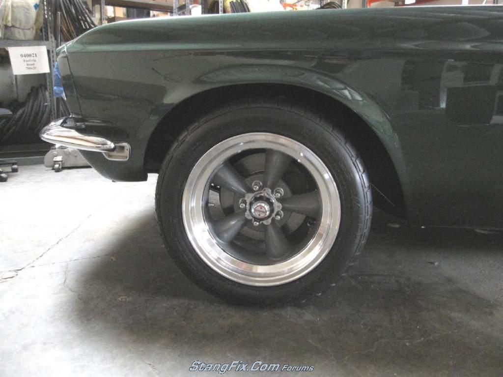

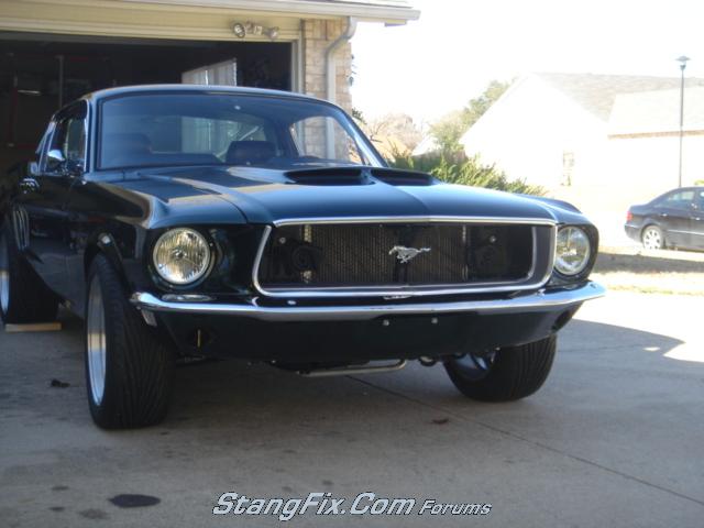

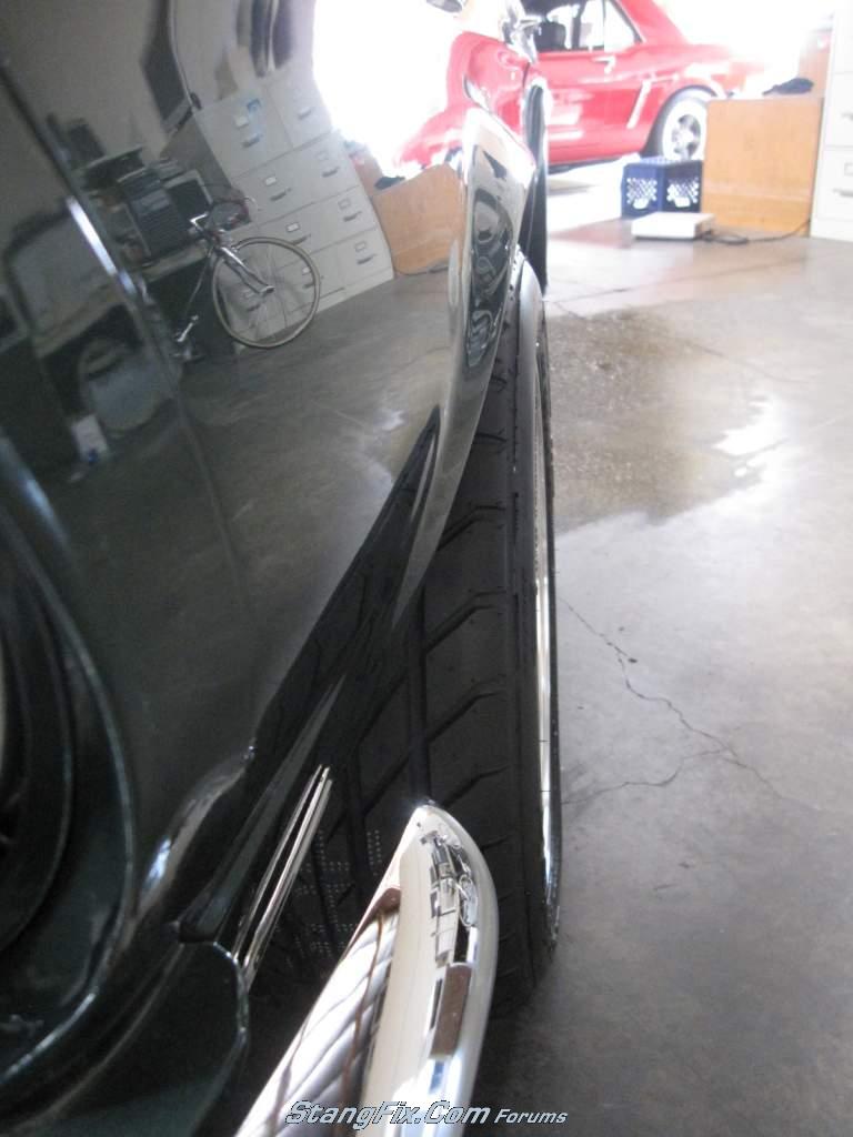

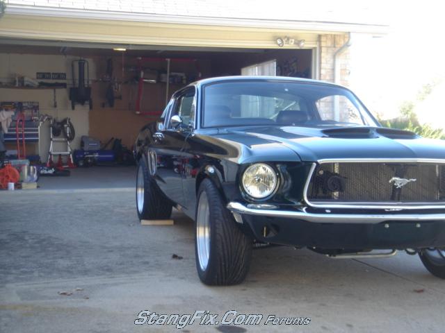

So getting into the issue, is 225 too wide for manual? Red is running 205 in front and 225 in back. Width of 225 is 8.88" whereas 205 is 8.07". Though you can't see it very well in the pic below, the tire is actually protruding outside the fender lip. Seems a little too much. No?

I don't think the effort to turn the wheel is that big of an issue, but I'd hate to see a tire come in contact with that brand new paint!
I have 225/50/16 on a 8" wide rim, and my tires are well behind my rolled fender lips. However, I'm running 2* of negative camber on my car. You might want to make the final tire width decision "after" getting your alignment set how you want it.

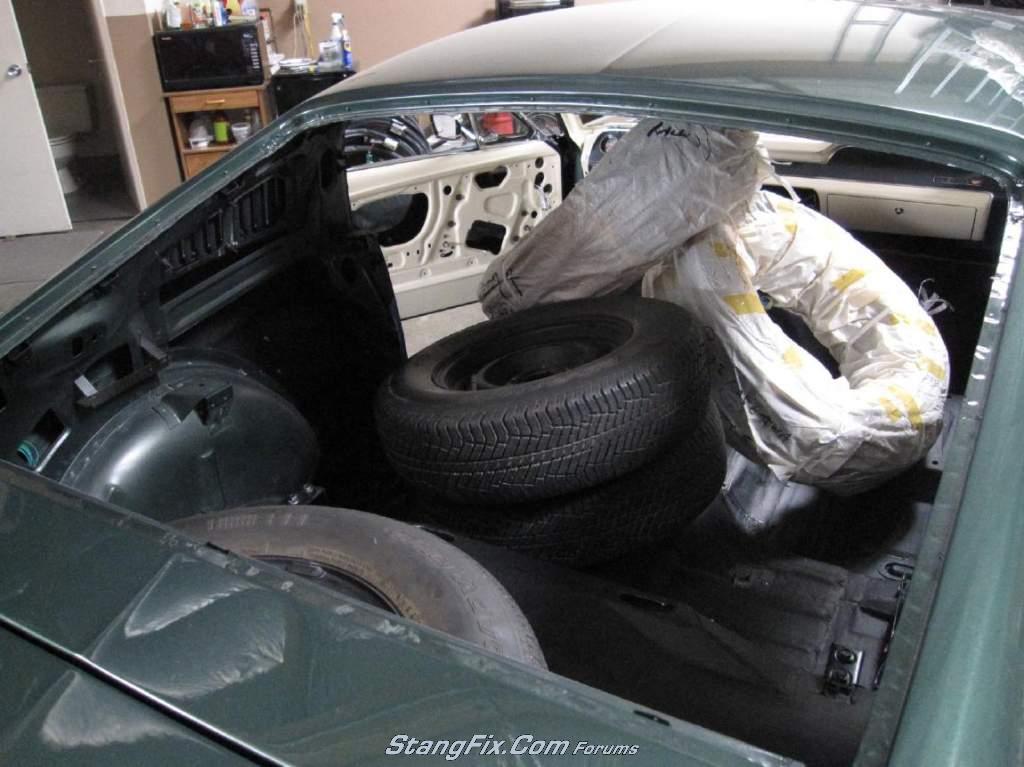

If you buffed out Macho Psycho path guys think the difference for steering is very little between the 205 vs 225, then I'll just stay with what I have. Michael I don't think I'll have any fender rubbing issues but I will go back and again weigh the car down a good 300+ pounds to compensate for missing glass, interior, missing gasoline, etc and do an alignment just to make sure I clear the fenders.
Speaking of adding extra weight, here is a pic of the front with 300+ pounds of extra weight added to the car. I was doing this to see how far down the car settles when having the missing interior parts. The rear wheel/fender gap is perfect. Odds are I will still need to lower the front end a little but won't touch it until I've put some mileage on the car.
Yes, alignment might bring the front wheel back to help clear the fender. Then again, will it push the wheel forward
If that is the case, those wheels don't have enough backspacing. The tire will get cut on a big dip with any friends in the car.
As for the steering effort, a 15" steering wheel will take care of it and I agree, the difference in effort from 205 to 225 isn't worth the swap. With more backspacing, you could run a bigger tire.
