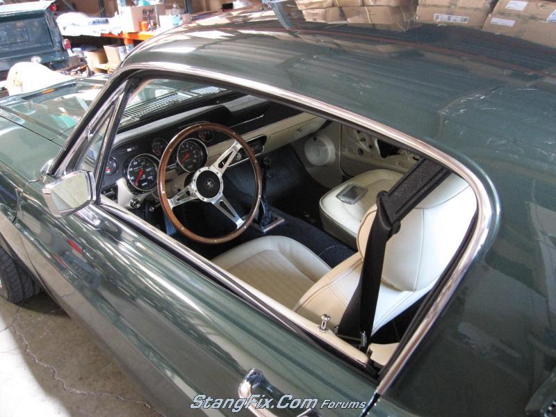

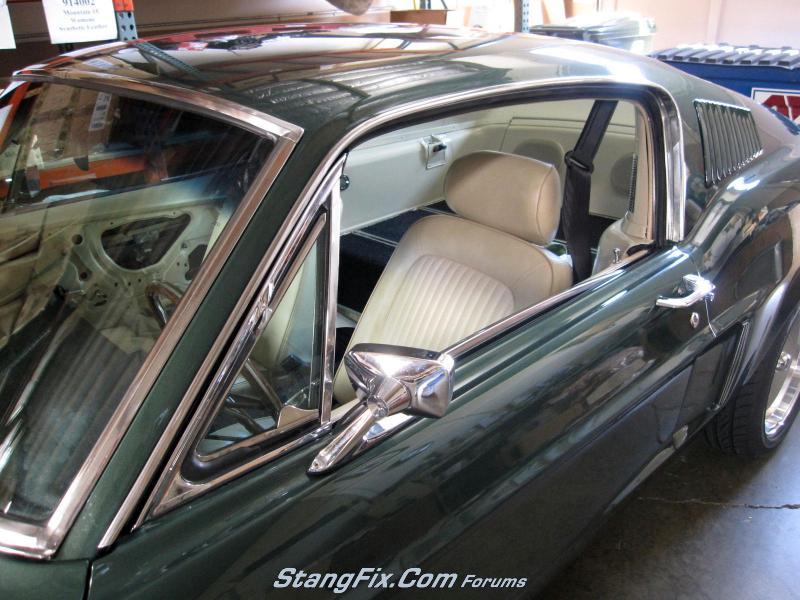

Shag and I just came back from my painter who installed them. Though he made it look easy, I'm glad I did not take this project on, though now I feel pretty comfortable in doing it after watching his method.

I did not take any pics for I was asked to help install them. Though I did mention front edge moving towards rear, let me go further into detail for actually we first made sure the front end would clear the door. Holding that position in place, we then visually checked to see if the corners of both molding and drip rail were in line. Once we felt comfortable we started at the upper front corner and rolled the molding place via upper edge in place and then with our palms rolled the bottom edge over the drip rail. Followed by a soft mallet and paint stick. Then moved from front corner to rear corner, twisting, lifting and rolling the molding over the driprail from top to bottom. Again followed with mallet and paint stick.
Finally went from rear corner down to the lower rear end.
Sorry if the above is confusing but we basically hooked the upper edge of the molding into place and then using our palms, rolled the molding bottom edge over the the bottom edge of the drip rail.
*Note: once in place, the sound it makes with the mallet and paint stilck is very distinctive. A very solid sound as compared to it not being in place.
