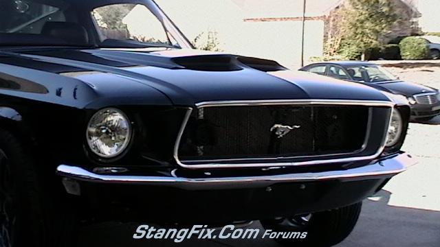

Let me say that mine does indeed look good, but over time it will most likely crack and I know that. I went this route mainly because the stock hood fit the car like a glove so there were a lot fewer hours in putting on the scoop than making a FG hood fit the car and worry about springs, warping, etc. The body man ordered the scoop from PAW because it was a solid piece and he was able to cut out the holes in front, leaving some of the material and not have huge openings.
Thanks guys. I am aware that it may crack over time too. I am planning on painting the hood a black or flat black, so if that happens, I can remove fix and repaint a little easier than if I were trying to match a paint color.

Bonding FG to metal IMO will eventually lead to cracking, so it's not "if" that happens, it's "when" that happens.
As stated, black is just as much a color as any other color and has the same issues with paint matching during a repair.
FYI, I'm using a '66 Shelby style FG hood with the steel reinforced frame. I use OE hood hinges and lighter weight hinge springs. The fit of the hood right out of the shipping box is "factory perfect". After 3 years the hood has not "warped" and I don't suspect that it ever will.
Yep, it will crack....just a matter of when. Maybe do a bolt on.....no bonding used....no cracking.
As to the matching black paint, I believe the idea is to paint only the hood black. Any repairs would then allow for an easy repaint of the entire hood only, not having to matching the car or the rest of the hood.
