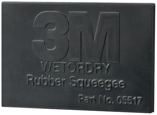

I use 4 of these. Two between door and rocker and two between door and qtr. THen use them on fenders and hood to get all gaps the same. Deck lids usually fit a little too tight for this method.
