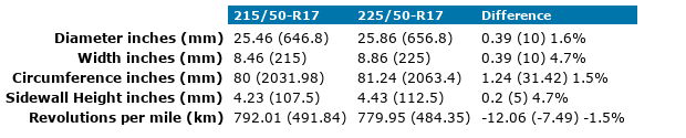

I am pondering getting 4 215/50-17 or 4 225/50-17 BFG G-Force Sport tires. Maybe run both sizes with the bigger on the back, the rears will sit just a tick higher but thats OK I guess.
A bit wider on the rears would not bother me, but I cant figure out what size that would be.
Here is a chart that shows what 215 on the front with 225 on the rears would look like number wise.

I have studied the chart by Dodgestang, but it causes headaches trying to sort out a specific car with tires and brands etc..

I agree with you about the 225 on the front Bob, it may be a bit much for parking, so I may need to reconsider two different sizes. I guess I could run a 215/50 up front and keep the 225 out back but if I am going to stagger how much could I do under theback with the same 17x7 wheel with the 4.25bs?
