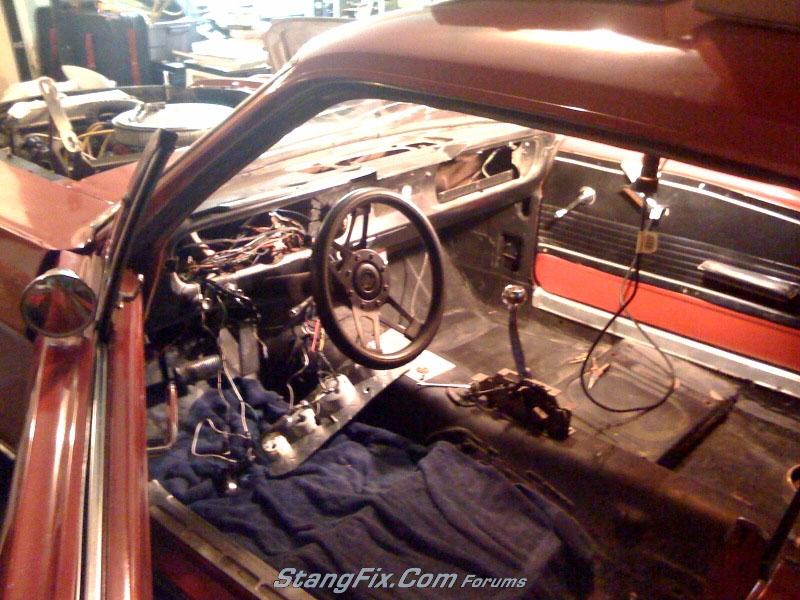

Good start.....get the steering wheel out of your way and there is a lot more room to get to things.
Are you bagging and tagging everything......?
If I remove the steering wheel.. then I can't sit in there and "drive" and make vroom noises to entertain myself! It'll get removed soon.
Bag-n-tag'n!! :thu
Good girl....but "Hood Things"..........how about hinge to hood bolts.....latch bolts.....hinge to inner fender bolts.....
Remember, you will be seriously tested on this upon the re-assembly........and we would rather not have to tell you "we told you so"...lol
