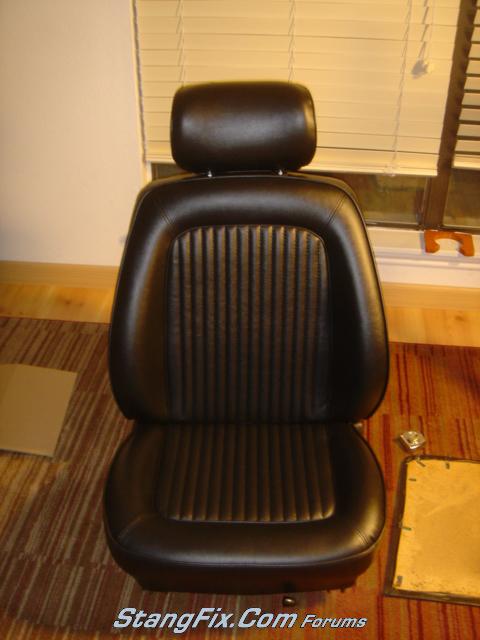

I've been very happy with my '68 sport headrests. They look great in the car, in the garage...
"cmayna" said:
Sorry, but I don't see how you can say that TMI sports headrests don't fit '68 seats. They do and fit very well.
I'm curious about the seat belts in this picture. Where are they from?
