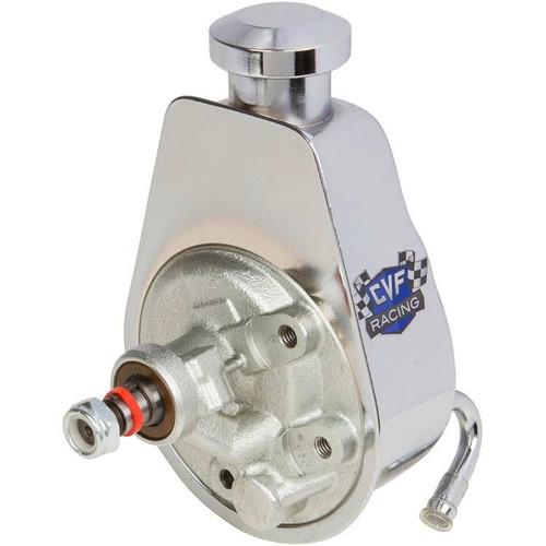

I have a Saginaw style pump in my car from CVF and its been a good part. However, it is vastly different in design and mounting than what you already have. I wouldn't go that route unless you have no other option.
