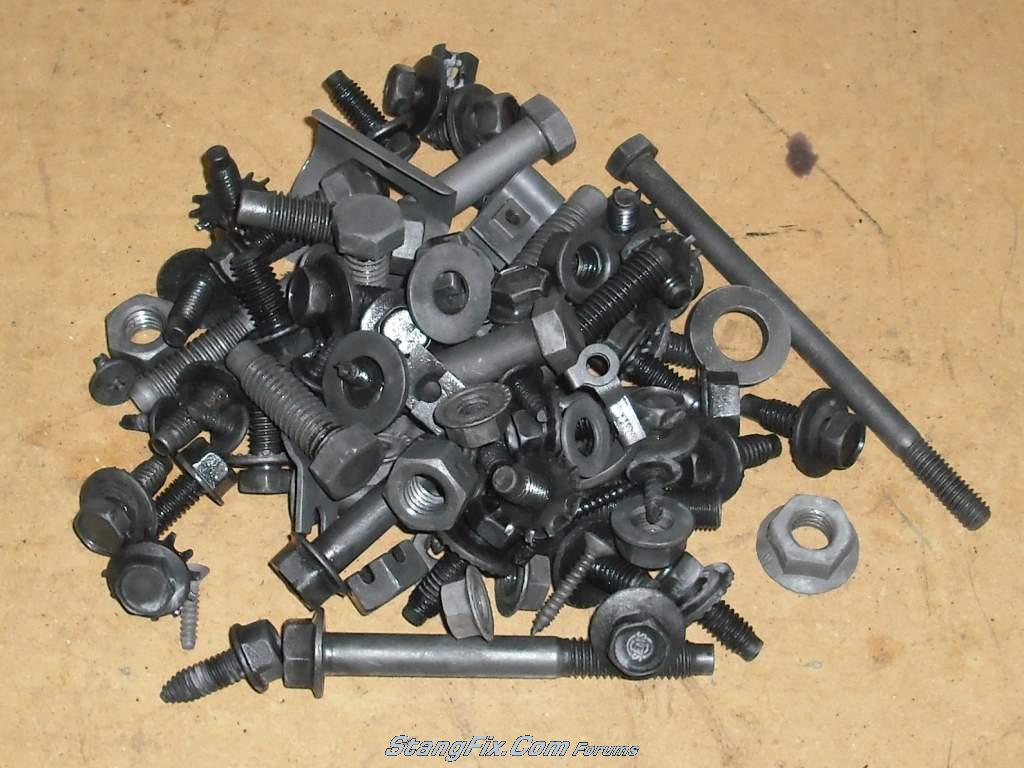

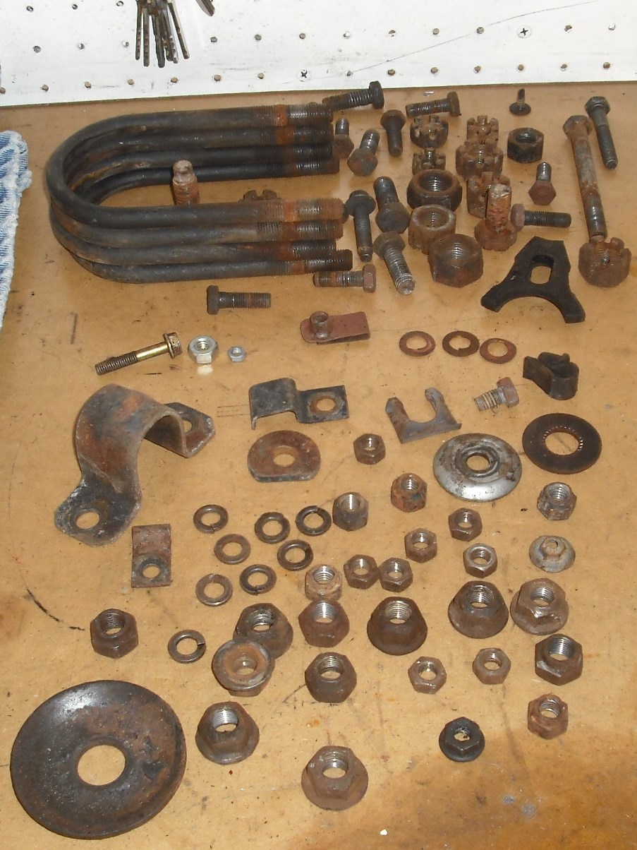

A pile of rusty and dirty bolts right off my Parts Car.

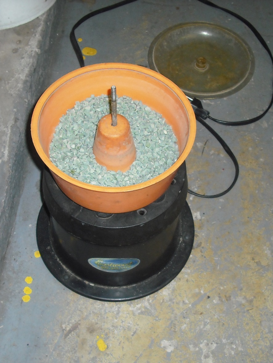

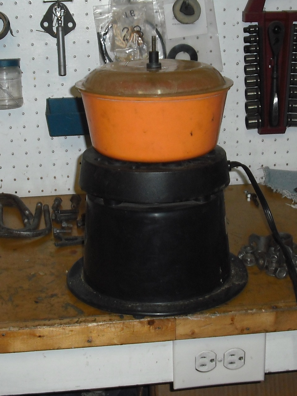

After cleaning and degreasing in the tumbler for 3 hours.

I got the tumbler (shaker) and green grit from Eastwood. The dry (Just add water) degrease/cleaner came from Caswell.

you have been busy! looks nice but if you sand blasted them, why did you tumble them? What exactly does that do? sorry for the stupid question but I have coffee cans full of nuts and bolts I might want to try this on.
I tumble them to get the dirt, grime and grease of of them. It will get some rust but not in the crevasses like threads. The sandblaster is quicker and removes the paint the tumbler did not get. I just do not want the dirt and grease in my sandblaster grit.

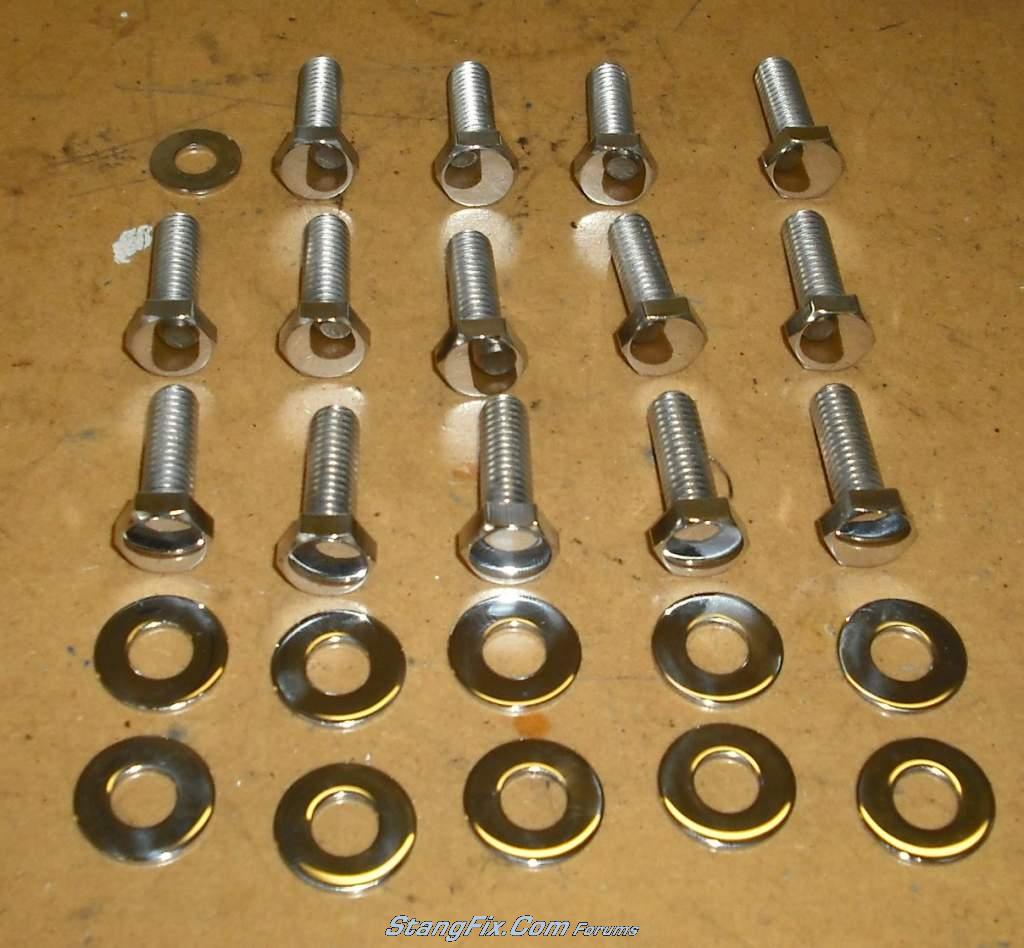

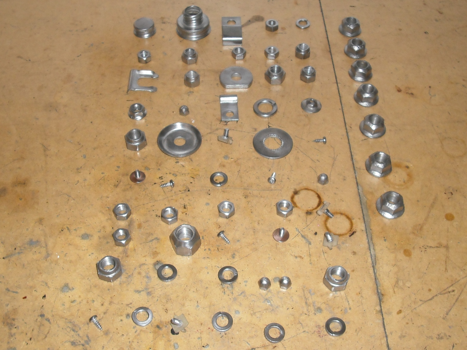

Saturday, I wanted a boring day after a tough week at work, so polishing out some of my stainless hardware was just the ticket.
I keep my sand paper in folders, and keep the folder in a rack.

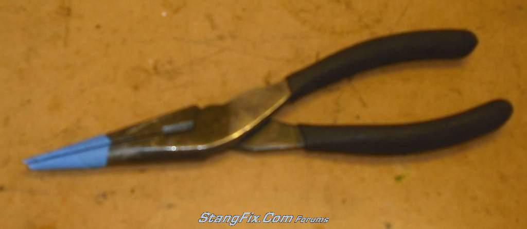

I put tape on my needle nose pliers to keep from scratching the polished hardware
Showing what the bolts look like are each grit of sanding and also the final polish with white compound.
Final Results
You should weld a nut to a pair of pliers, screw the bolt to the nut and use a sander, seems like it would save a LOT of time on the bolts, the washers on the other hand....

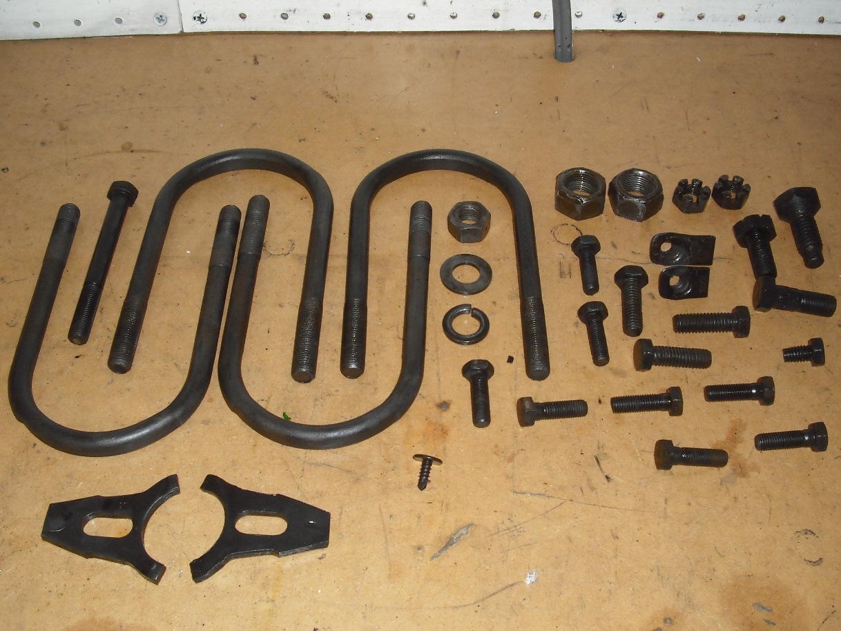

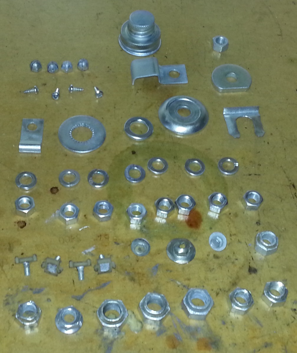

Sandblasted some more parts.
Parts polished and the threads chased
Parts are now zinc plated. Took a picture of my plating setup but it came out blurry. I will try again later.
