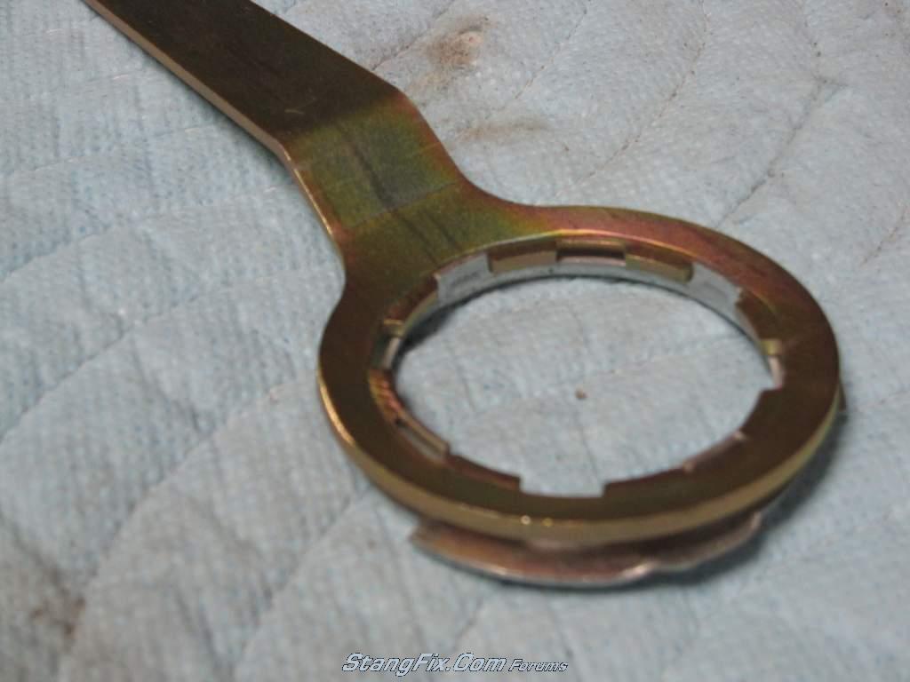

Here, I never knew this tool existed until I was snooping around ebay. Its a sending unit lockring tool, which makes it so much easier to remove and install the sending unit lockring. A whopping $10 expense. Since I still need to resolve Red's sending unit issues, I see this tool coming in very handy. I forgot to take a pic when I was actually using it on Shag earlier today so I did this mockup showing the tool with the lockring.

That is a neat little tool though, gonna have to remember that exists!
