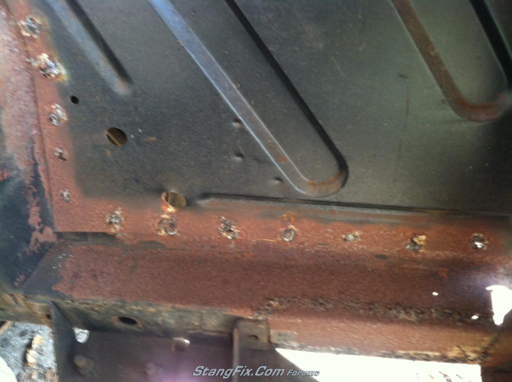

Looking over my latest project, it has had a lot of metal work done. But I'm fining i don't like the look of the welds. 90% don't look complete and clean, maybe poor penetration. I think it was likely done with a flux core wire feed. I just received a new mig welder for my birthday so my plan was to clean all these weld up and grind them smooth etc. My question is what is the best way to get into all the little crevasses in the welds to get them clean and properly prepped. Should I just go to town with a wire wheel and grinder to start? What would you folks suggest? Here is a slightly blurry pic so you know what I'm dealing with:
Wow, that looks like Jeremy did the welds.
Try using a flap grinder to clean one of them up and re-weld starting in the center and then using a circular motion work outwards. It should melt it all back together. If you get the temp right, it'll look a lot like a factory dimple weld instead of that shart!
or
If you're really ambitious, drill out that crap, remove the panel and start over.
I agree with "mustangstofear". If you like the allignment, grind down a weld, rosette weld it back up and do it again maybe on the opposite end, kind of jumping around to keep the heat down.
A few tools that can come in super handy that I have been enlightened to by the amaizing John "opentracker".
You can use this one to prep the spot where you will be welding and at the 90's where the panels meet.
This one is great to grind down the welds and even them out with the panel if that is what you would like to do, or you can use a sanding disc with a backing pad on your angle grinder.
Well, this one I am sure you are aware of, use it as you please, it is always exciting to use.
One of the coolest things John showed me, other than everything I know, was to put this cool crimped wire brush in a vice and use a cuttoff wheel to narrow it down so you can force it into the hole cutouts where you will be rosette welding and for corners.
Hope it helps bro.

If it were me, I would skip all those abrasive grinder wheels and use a spot sand blaster. I would prefer the HF unit as it would be easy to add a small extension pipe to the nozzle to help get into tight spots. The Amazon unit recycles the sand so it would be cleaner, however the cost is that the nozzles tips look bulky and you could not get into smaller areas.

Thanks for the advise folks, I'm looking forward to digging in and cleaning thic stang up. But first I need to deal with the cleanup from Irene...
