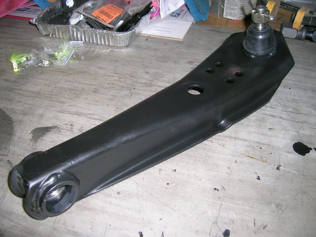

Here is the last piece of my Opentracker knock-off suspension, the LCA's:
New repro arm w/ washers tacked on for hole saw pilot:
Cutting and Cut:
Machine the sleeves, first time making an internal snap ring groove:
Weld in the sleeves:
Here are the bearings, stainless steel, Teflon lined, static rated at 30,000lbs:
Paint and install:
Should probably replace that ball joint with something decent...

Yep - Close to it. The load rating on ours says 32,000lbs, but hey, what's 2,000lbs among friends.
