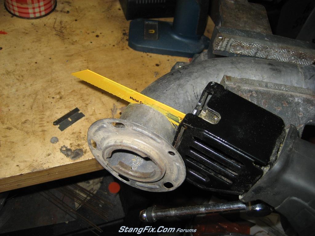

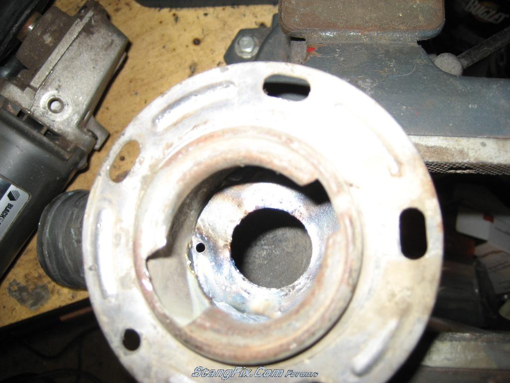

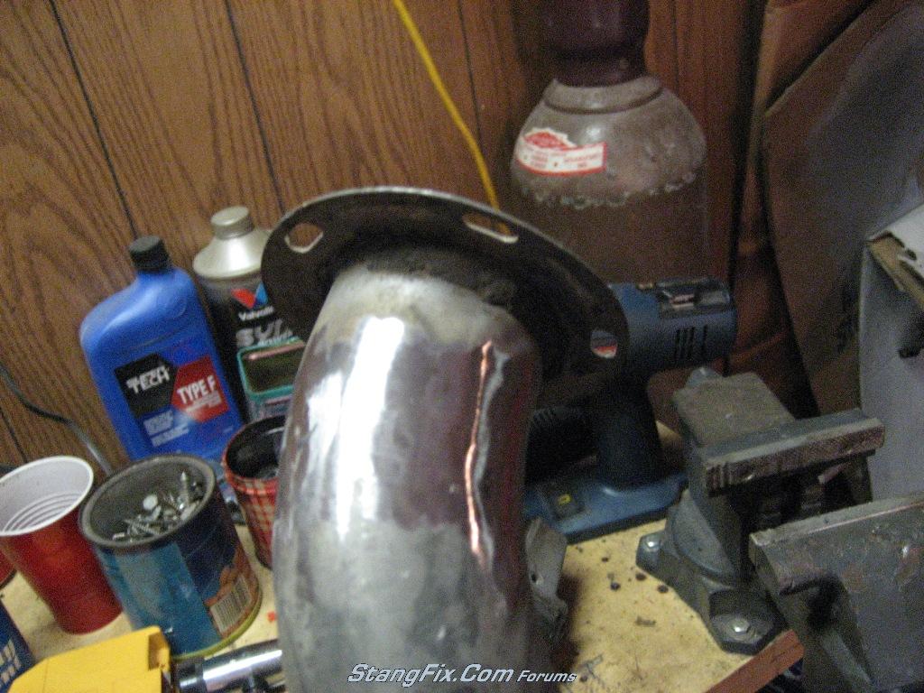

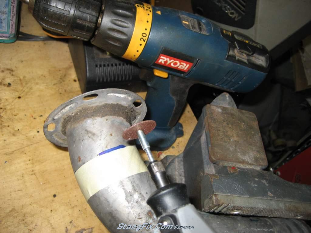

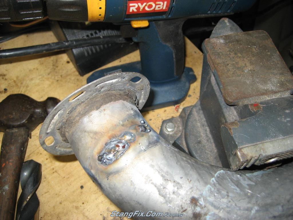

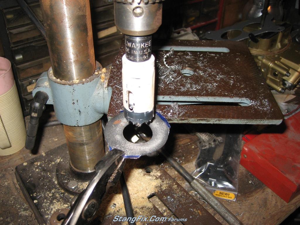

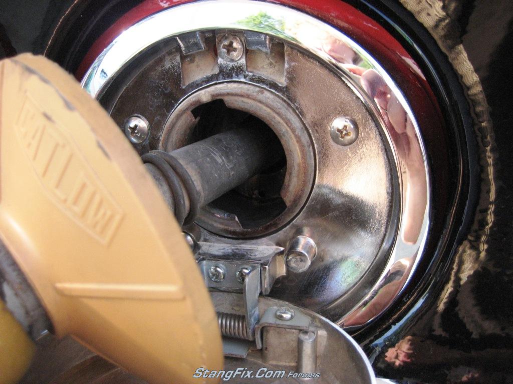

okay, I tried today to make a fuel filler neck like the newer cars with a smaller hole. I cut some flat stock, left tabs on either side (for support). One large and one smaller. Then sliced into the neck with my sawsall halfway on one side and small notch with dremmel on the other. Slid the disk in for test fit, then cut the hole, and welded it in. My welds weren't too pretty so I ground them smooth. Here it is:
what do ya think? Havn't installed it yet... Hope it works.

I just went up to the BP with a 1/4 tank. I filled up at full blast! No splash!!!
keep in mind we don't have those smog nozzles in KY...

I noticed in one of your "assembled" pics that the plate had a small (1/8" ?) hole in it. Was that intended as some sort of vent? Or just a coincidence?

The 1/8" (good eyes) hole is a drain in case some fuel would get on the gas cap side of the plate. That way it can drain back into the tank. It will also double as a vent I guess...
