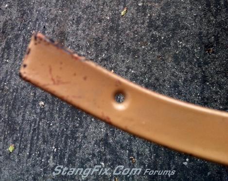

OK, Here's the scoop on 65 thru 68 trim pieces. Per my local Mustang shop 65 & 66 are the same. 67 & 68 are the same. I know the 70 doesn't use one so I assume neither does a 69.
The 65/66 are 28.5" long
The 67/68 are 27.5" long
The extra inch can be seen on the outside ends (closest to the door).
Here's some 65/66's which the hole is 2" from the end:

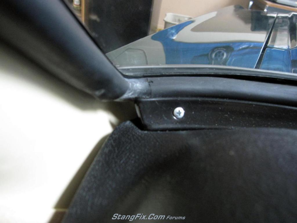

Here's Shag's trim piece. Note the hole is 1" from the end:
Finally the distance between the holes are also different. Measuring center to center from the center screw hole going outward:
65/66: * 12.5" * 8" * 5.25" *
67/68: * 11" * 7.25" * 7/5" *
Now, can I go back to sleep? Oh and yes tt400, the brown 65/66's are yours. Being shipped today.
