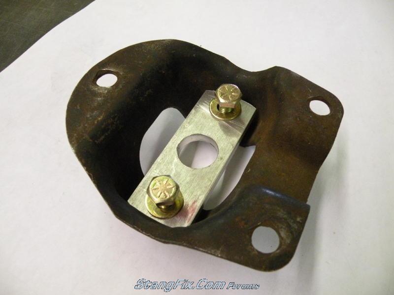

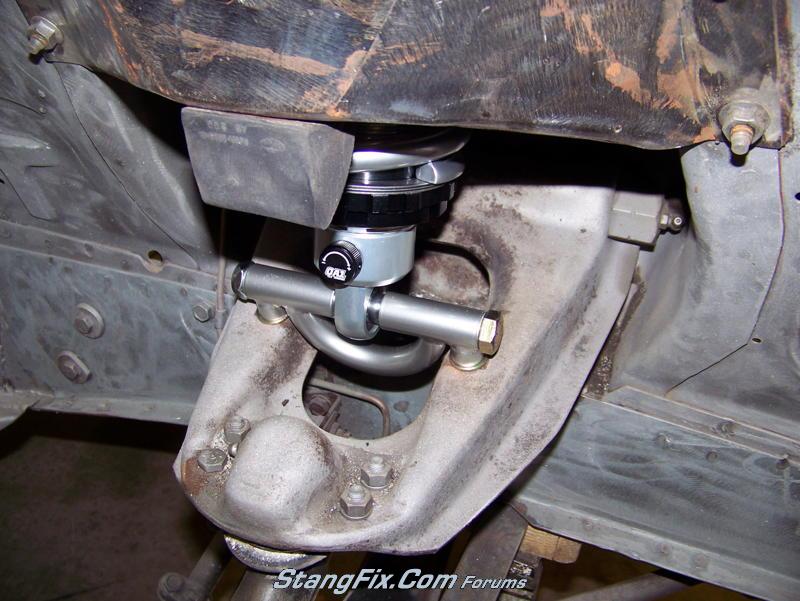

This will be for the 69 I am putting together. I don't have it yet. It was being shipped today but I do have the pictures that MPR Race Cars sent me. I am not real good at posting pictures but if someone can do it for me i will send them to them.

Hey thanks for posting the pictures Sluggo. As you can see from the pictures the springs have a 4.100" inside diameter on the top so they will sit in the stock spring pockets. The main reason I went to coilovers was to be able to adjust the front ride height.
Dude! That is sweet! I like how it looks. Are you running stock upper/lowers or do you have some sort of tubular option? And what a killer price for a coilover!

Steve for a street car the only real advantage is to be able to set the ride height at where you want it. Now a track car that is a whole different ball game. On a track car it gives you the ability to make a number of different adjustment. You would be able to adjust the ride height, change springs faster and adjust the cross weight in the car easier. Basically dial the front end in alot closer. And if you add coilovers to the back now your whole car is adjustable.
I will be using modified stock control arms. The uppers will now ride on roller bearings and the lowers will be on rod ends. It will also have an adjustable strut rod set up. What I am trying to do is free up the movement on the front suspension.
