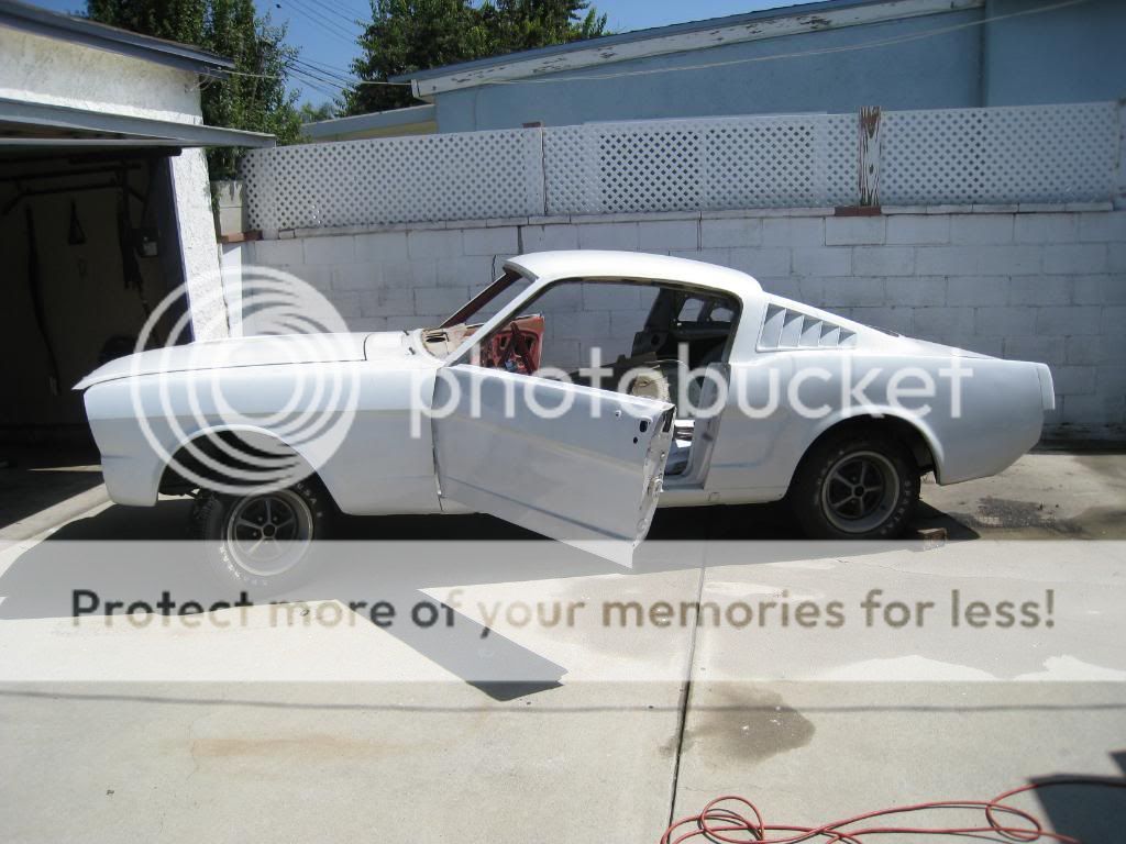

Anyways, here she is:

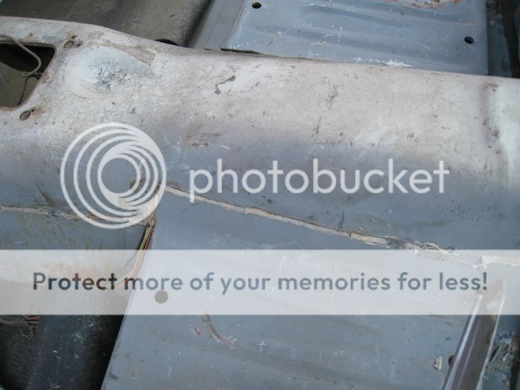

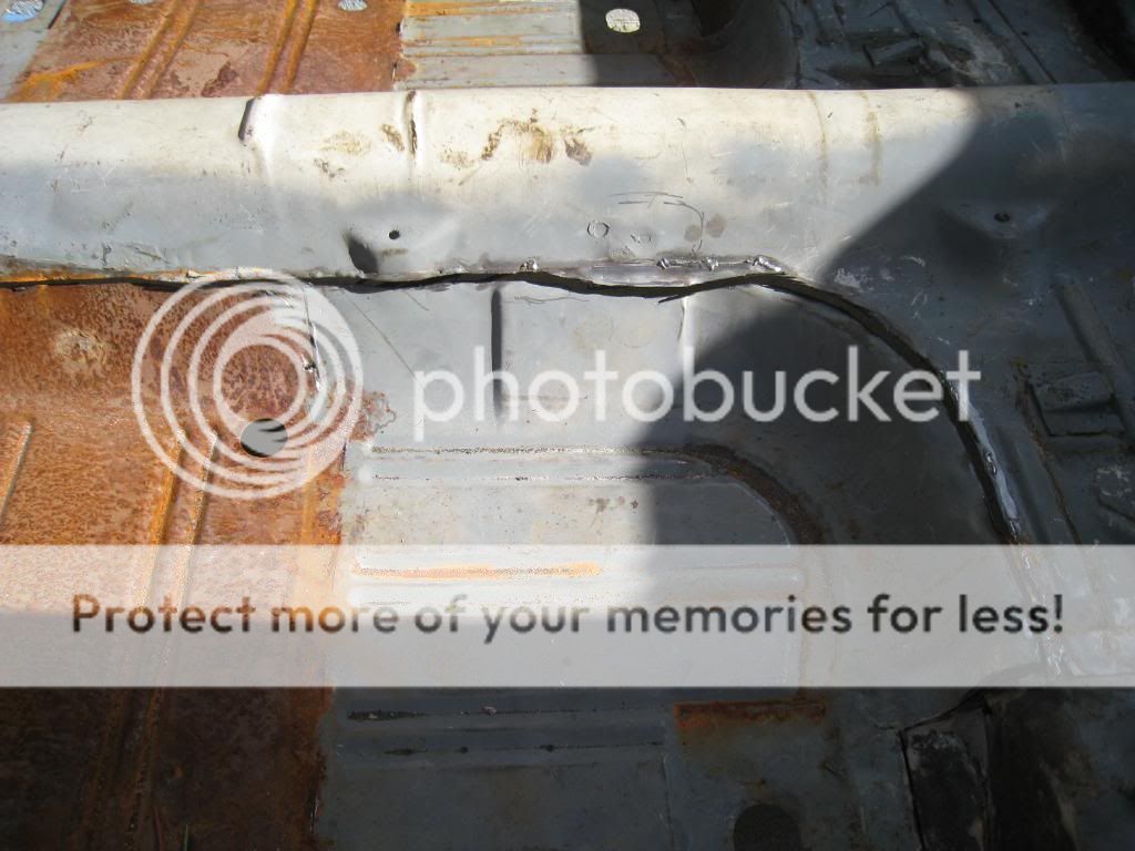

First, both the driver and passenger floors were replaced, but not in a way that would ever be safe to drive. It was tacked in, and covered with seam sealer. Not even welded to the frame rails. I wish I was kidding.
At the time I bought it, I not only couldn't weld, but did not own a welder. Well, I knew that was about to change... So I jumped in on the floors. I started by cutting threw the overlap, so that I could butt weld the two together, for a better finish.
Some of my first welds. Ugly, I know. BUT, eventually I got the hang of it (as you'll see later in this monster post).
Ground down. Eventually covered with seam sealer and painted. I don't have photos of the finished floors, but I'll update soon with them.

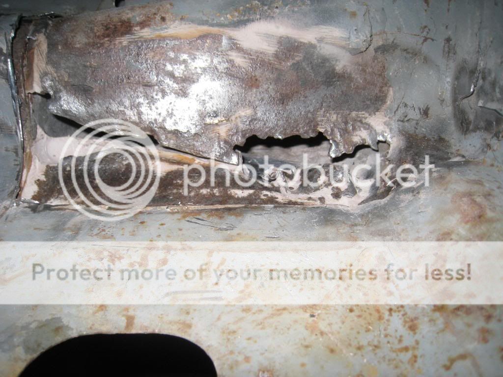

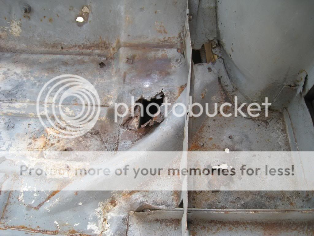

Then we have the rusted through rear torque box, covered over with bondo (photos taken after wirebrushing all bondo away).
This was my first major panel replacement. Done in an unconventional way, I'm sure... but it worked:
Additional rusted panel in the rear floor, which was also replaced:

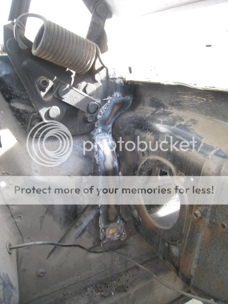

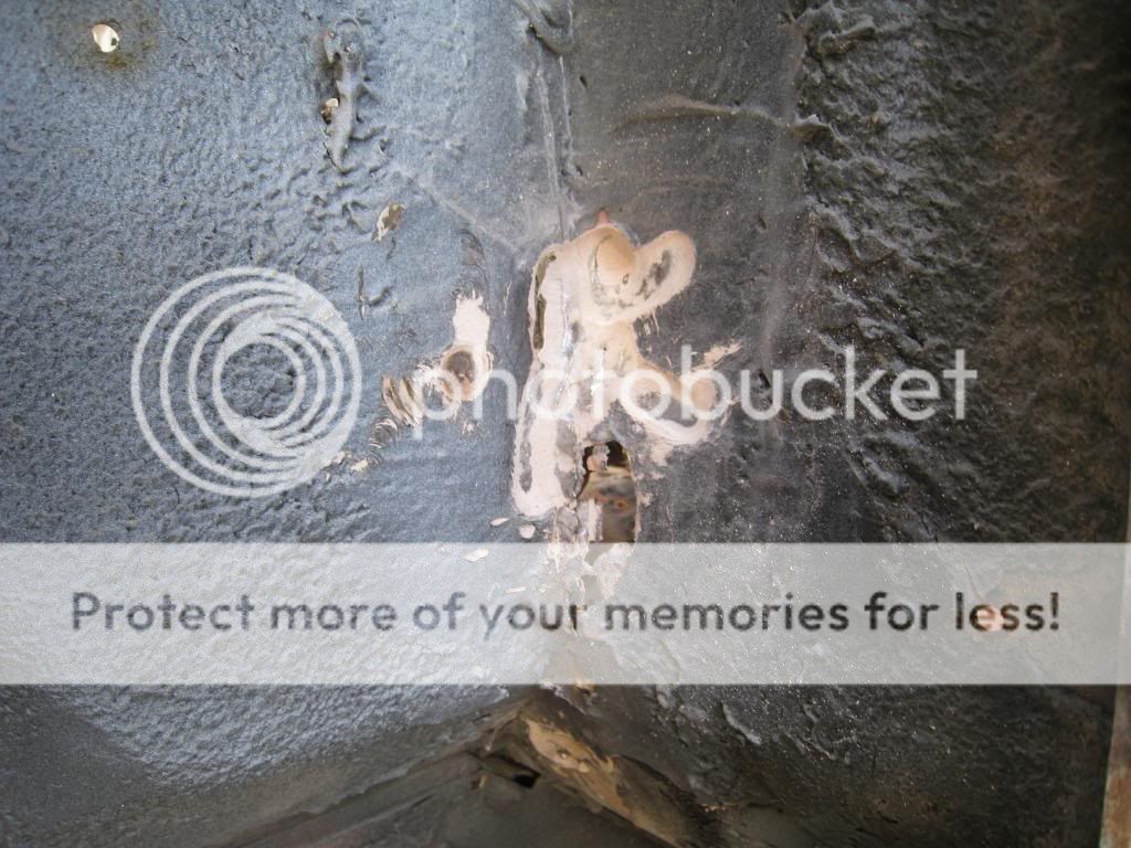

Moving on, we have the bondo'd holes in the firewall.
http://s984.photobucket.com/albums/ae32 ... G_0030.jpg
More rust where the pender apron meets the firewall (bondo'd of course...)
From inside:
Replacements:

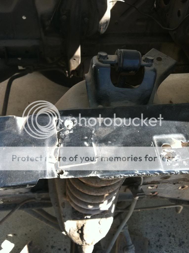

The drivers side front frame rail was rusted out. The packed it with newspaper and covered it with bondo. Yes, THEY PACKED THE FRAME RAIL WITH NEWSPAPER AND COVERED IT WITH BONDO.
Outside, patched up. I decided to weld in the interior bumper bolts:
Inside, patched up:

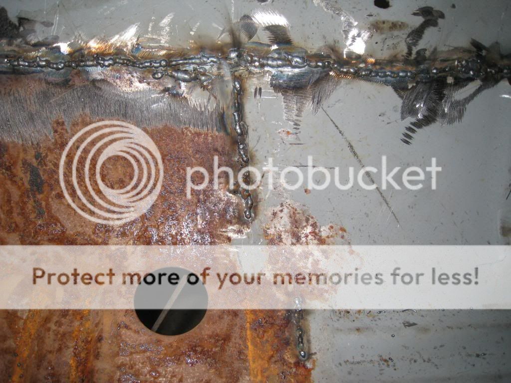

And I still have a TON to do. Every time I fix something, I realize that 3 more things need to be fixed. As an example, nearly every weld is wrong on this car. Every panel is tacked, instead of plugged (and some of the welds are just plain UGLY):

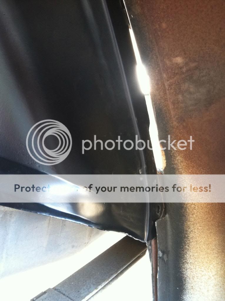

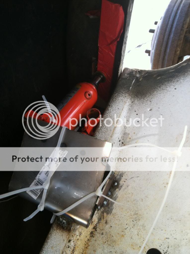

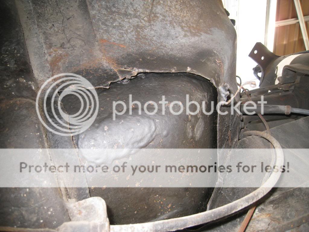

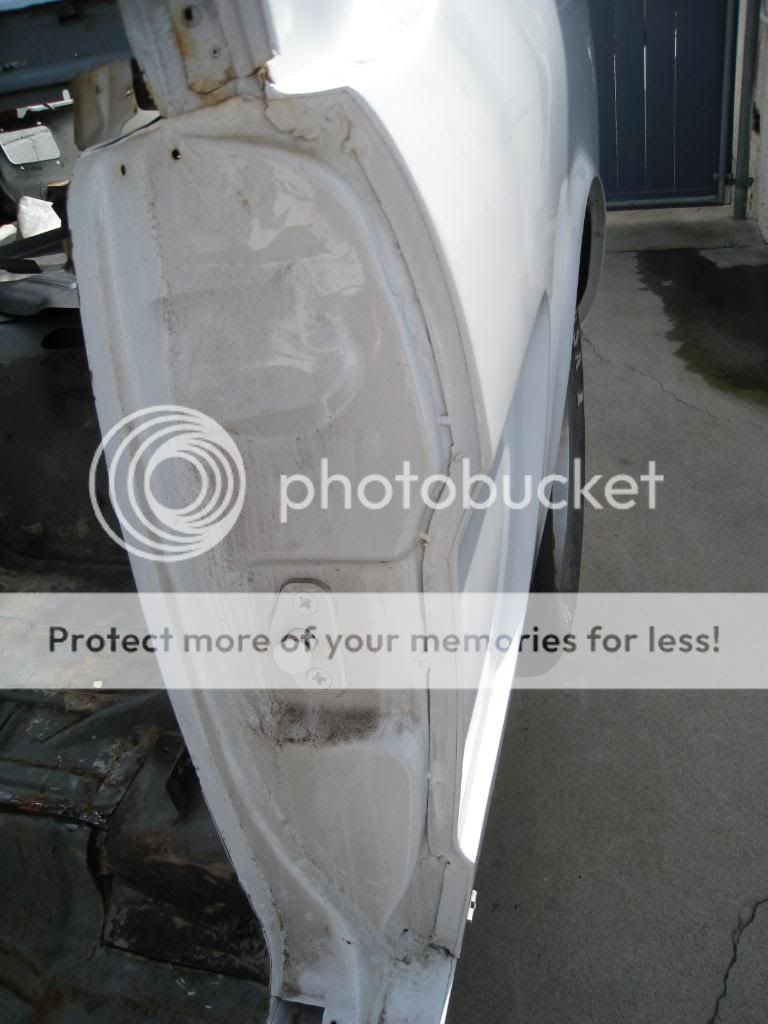

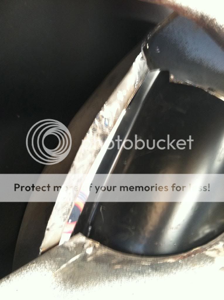

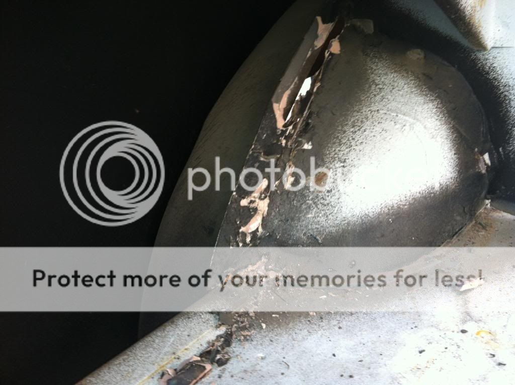

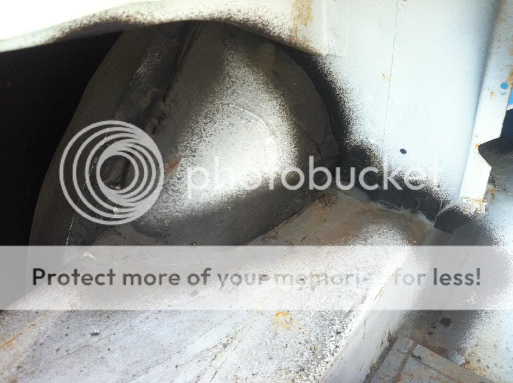

Now, what I'm currently working on... replacing the driver's side rear inner wheel well, with the outer wheel well and fender install (A challenge... I know.)
It was previously replaced...incorrectly. And there was a large gap between the outer and inner wheel well, which was bondo'd over:

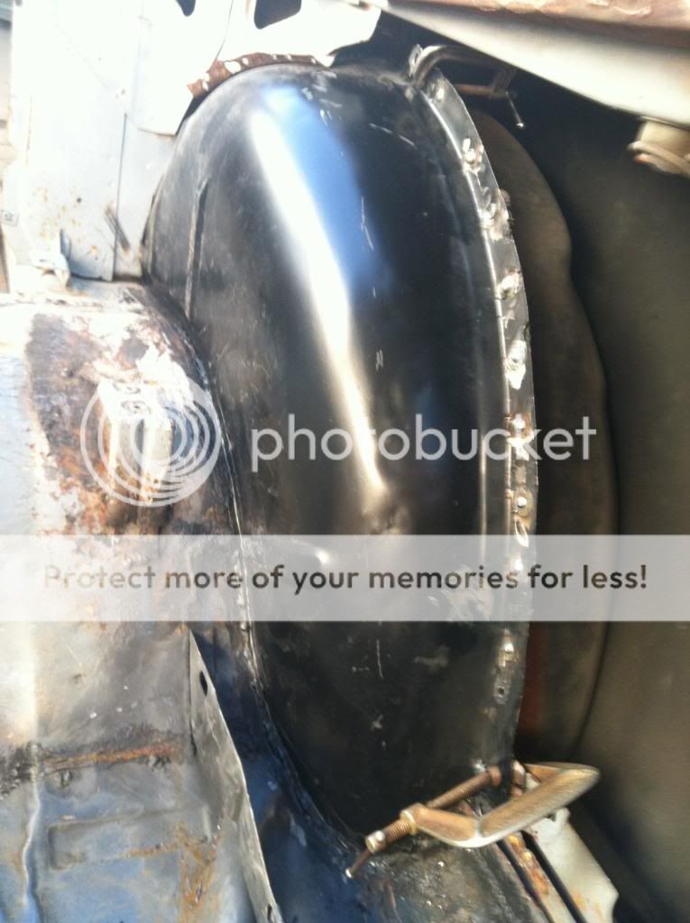

Test fitment of the new interior wheel well showed I still had a large gap, and the outer well had to be pushed forward:
So, I pushed it forward
A much better fit:
