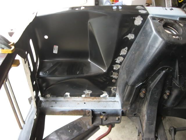

Agree with Steve, I had to replace my rusted out battery tray area due to the previous owner using it for a battery shelf rather than beer storage:
While moving the battery does remove 40lbs + off the front end and places it above the driven axle for traction the main reason if for the BEER SHELF it creates.
